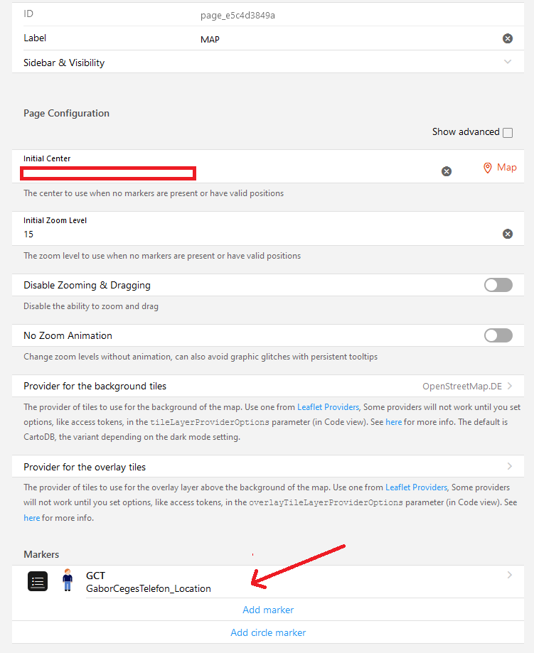

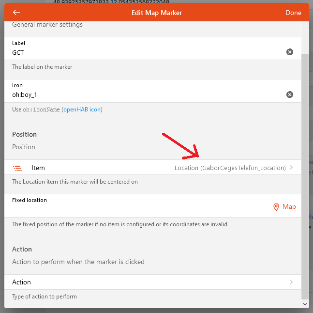

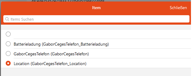

-if i make a new page:
“Pages” – “Create Map view” and add the same item, as for the sitemap, the marker is not visible.
i can set a fixed position, i can set the icons, everything is working, only the item driven position not.
