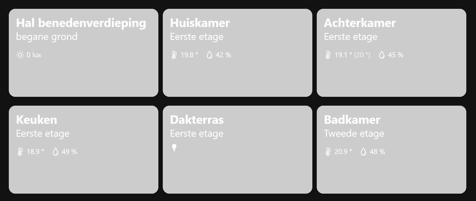

I have added a background image to some of my location cards
In the form of http://openhab:8080/static/images/rooms/xxxxxx.jpg
When I view them thru myopenhab.org (web site or Android app) they don’t show up (not visible)
Am I doing something wrong. For example, should I format my URLs differently.
Or is it not (yet) possible via the cloud.

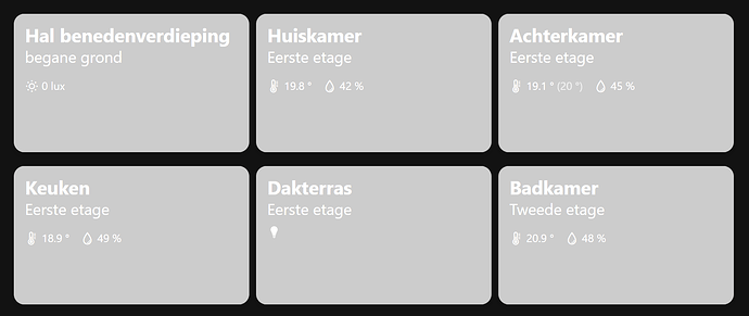

Try it with relative URL /static/images/rooms/xxxxxx.jpg
Why haven’t I thought of that. :blush:
A relative path (URL) works perfectly
