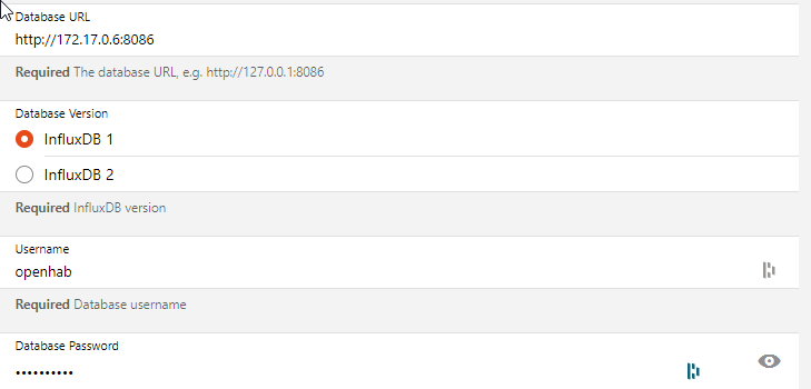

InfluxDB Persistence Service is not able to connect to InfluxDB.
When I have setup like this:
I see in logs:
2020-12-28 16:18:46.403 [WARN ] [rnal.influx1.InfluxDB1RepositoryImpl] - database error: java.net.ConnectException: Failed to connect to /127.0.0.1:8086 org.influxdb.InfluxDBIOException: java.net.ConnectException: Failed to connect to **/127.0.0.1:8086**
When I change it to:
I see in logs:
2020-12-28 16:26:24.638 [WARN ] [rnal.influx1.InfluxDB1RepositoryImpl] - database error: java.net.ConnectException: Failed to connect to localhost/127.0.0.1:8086 org.influxdb.InfluxDBIOException: java.net.ConnectException: Failed to connect to **localhost/127.0.0.1:8086**
