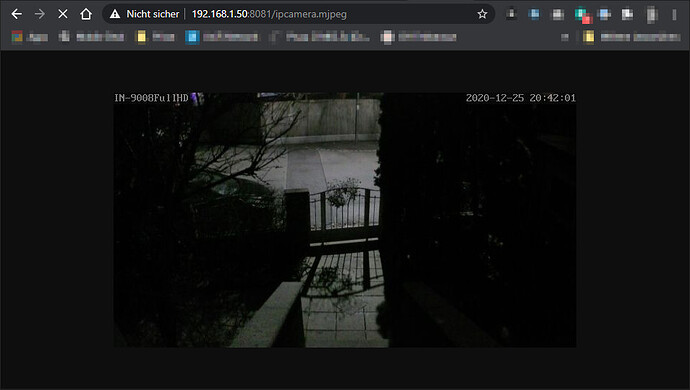

When I go to the local url/port as defined in the thing (for me: http://192.168.1.50:8081/snapshots.mjpeg), I get a picture without any problem. What’s wrong here?

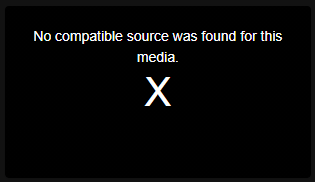

The new UI isn’t even better:
Also tried various mime types, no luck.

The address provided by the item looks fine:
There may be a bug with the video element, try using the webview element instead. I don’t think this is a binding issue as I have seen multiple people comment now on the video element so this may need an issue raised in GitHub to be looked at.
