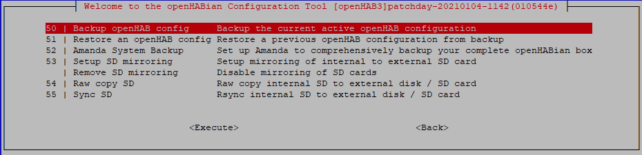

Using ‘/etc/openhab’ as conf folder…
Using ‘/var/lib/openhab’ as userdata folder…
Making Temporary Directory
Extracting zip file to temporary folder.
Backup Information:
Backup Version | 3.0.0 (You are on 3.0.0)
Backup Timestamp | 21_01_17-18_21_31
Config belongs to user | openhab
from group | openhab
Your current configuration will become owned by openhab:openhab.
Any existing files with the same name will be replaced.
Any file without a replacement will be deleted.
Okay to Continue? [y/N]: y

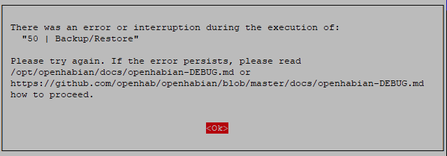

I even have a problem to make a backup. I think I have a probelm with the envirements-variables.
I use ubuntu 18.04 with manual installation. Before I had OH3 installed using apt-get. But as I had problems I removed the apt-install and installed OH3 manualy (in opt/openhab). Now the variable $OPENHAB_USERDATA is set to /var/lib/openhab. So the backupscript is not working.
How can I change the variable?
Or what can I do to fix the problem?
Thanks for any hint.
I think it needs to be an absolute path. So a leading / is missing.
make sure that the environment variable is set in a user profile script for all users like denominator described. There already should be a file doing that in your installation.

After a reboot I can say that i’m a big step forward. Backup is done now. Only a one message, but I don’t know if its a problem or not. Not tryed to restor yet.
