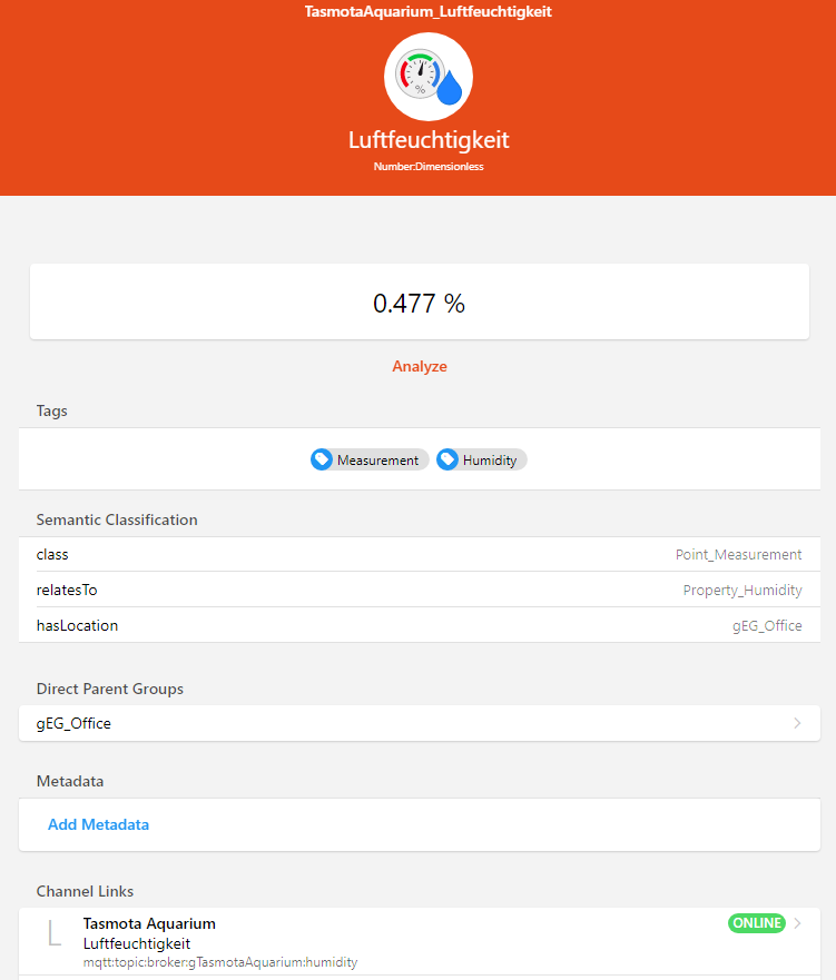

I started with OH3 and successfully created a Tasmota Thing, Channels and Items via the UI:
one of these channels represents a humidity sensor which reports a value of 47.7 which is somehow reported as 0.477%
why is it not showing the original value coming in from MQTT and how to correct this?

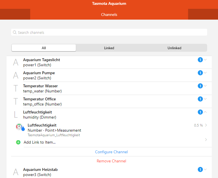

you`re right! curious where that Dimmer came from, not able to change it so I just deleted and created a new item…
thanks!
Dimmer is chosen, when you choose “Percentage” as property instead of “Numer”. A little confusing, yes
