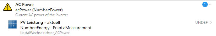

An item providing AC power (Watts) gets state “UNDEF” when the equipment goes into idle mode.
I would like the item state to remain on 0W (zero Watts) in such case.

2021-03-06 17:55:51.926 [INFO ] [openhab.event.ItemStateChangedEvent ] - Item ‘KostalWechselrichter_ACPower’ changed from 0 W to UNDEF
Channel/item:
ACPower

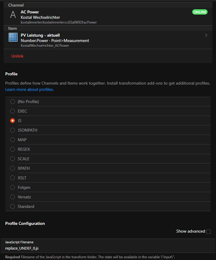

The basic approach would be to use a transformation, probably a JS javascript, to examine state “incoming”, replace UNDEF with “0.0 W”, and pass everything else to “output”.
You will need to take care around the state being a quantity type, coming with units (W).
You may be able to apply this transform at the channel, depending on the mystery binding, or using a profile applied to the channel-Item link.
Both those methods will affect Item state.

Eventually I managed to create the transformation file (replace_UNDEF_0.js)
(function(i) {
    if (i = "UNDEF") return 0;
    return parseFloat(i);
})(input)
UNDEF
However, I failed to do …

replace_UNDEF_0.js:
(function(i) {
})(input)
I was trying with:
JS(replace_UNDEF_0.js):%.0f W
and
just for running the script … but didn’t work.
Whatever I do, the string “UNDEF” remains as items state…
What is to be entered to the “Pattern” field in the items metadata to run this script?
.. and add the “%.0f W” ?
Thank you!
