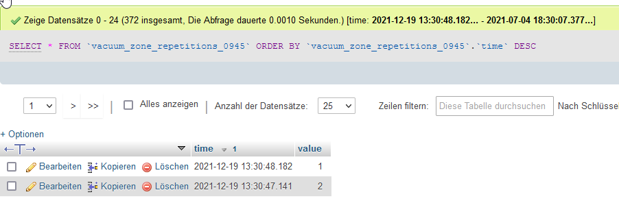

  5. I see saved values in MariaDB / phpmyadmin.
