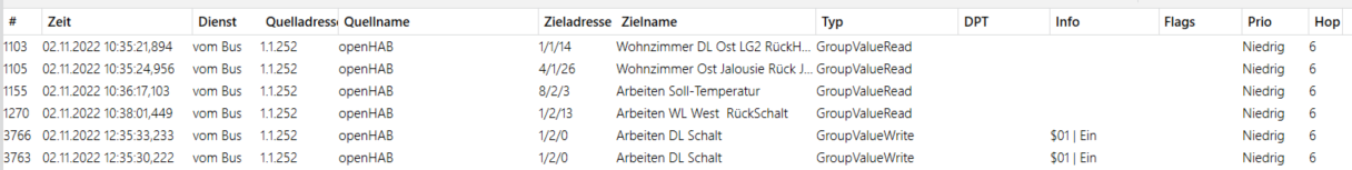

There’s KNX readouts from openHAB, which do come through and I can send commands to e.g. light GAs:
grafik
(strangely the “Switch”-command to 1/2/0 came two times within 3 seconds? I did trigger it only once.
