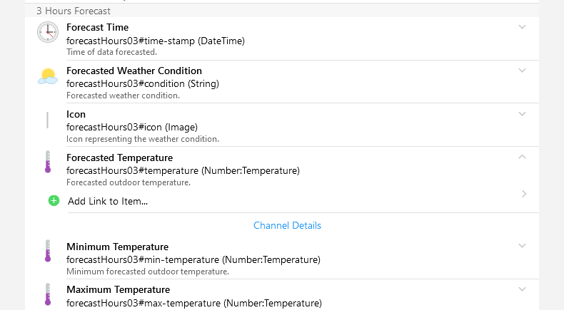

Click on the OWM thing and open the channel tab

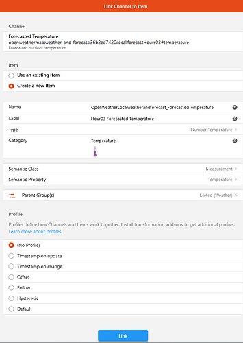

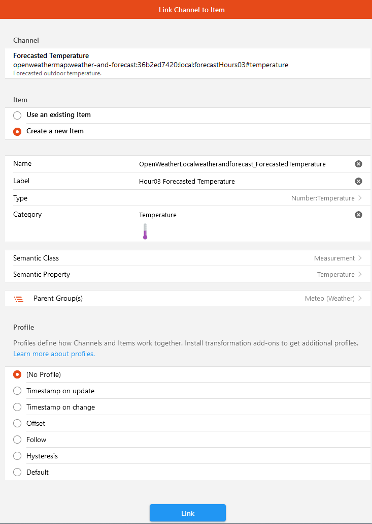

Then i clicked on one of the channels to link to an item called hour03 forecast temperature
Add the link to item
click on link and i see that the item is linked and i have a value

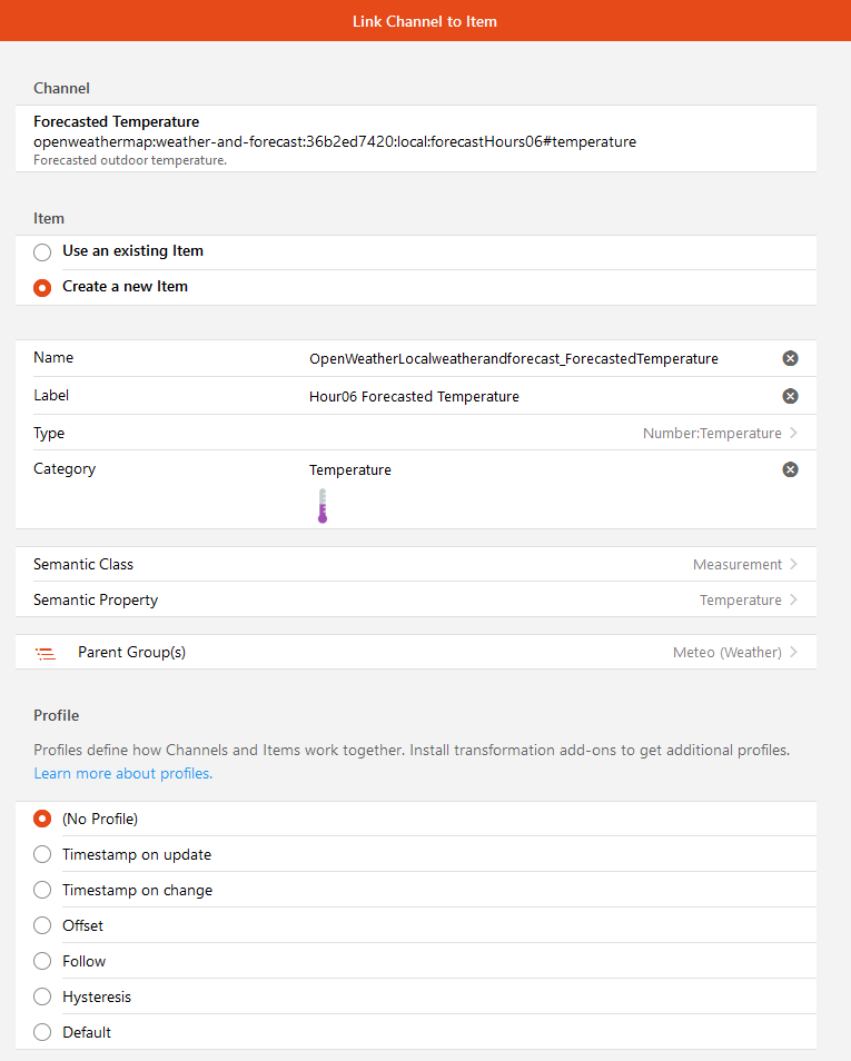

Then did the same with a second link (hour06 forecast temperature)
and i see the second linked item and the value

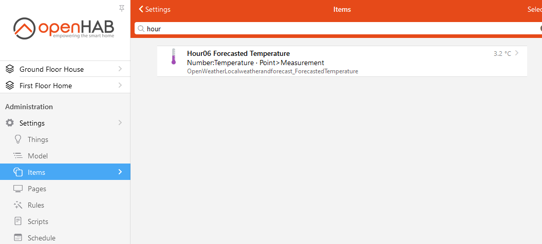

I then clicked on the items tab in the left column and search for hour.
I should see the two new linked items
But i only see the last add linked item !!!
Going back to the things tab, this is what i see
Hours03 has disappeared and i only see 2 times hour06 !!!
The Hours03 item has suddenly changed to hour06
