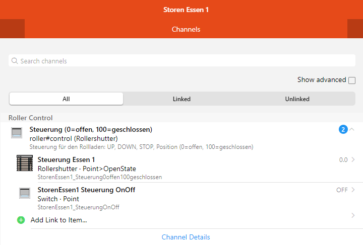

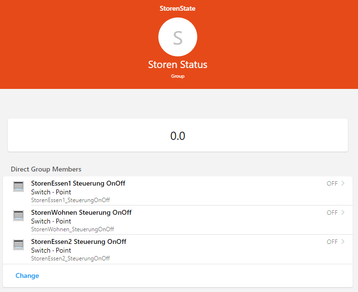

Blinds
My widget is not 100% correct with the blinds. I’ve put the rollershuter-items into a group with SUM aggregation. In the widget there is a floor operation. If now two blinds are closed by 51% each (SUM: 1.02), the widget will show only 1 complete closed blind.
Other possibility it to add a new Switch-Item to the Rollershutter-Control-channel (see picture):
And then put all Switch-Items into a Group with SUM aggregation.

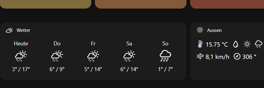

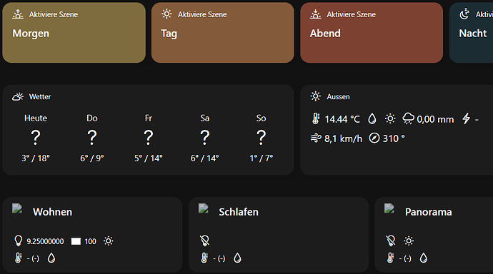

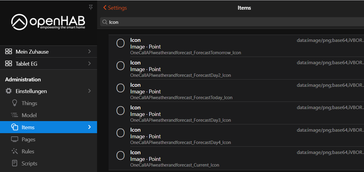

Thank you @Integer (Mike) for providing pages and widgets. I like them. I’m still using my OH2 sitemaps but have already migrated to OH3 and have started to build the model and pages. I’ll use your pages and widgets as starting point. As I’m a beginner with YAML its still difficult to understand all the details of your pages and widgets. Changing the Items is easy but formatting and other things is more difficult to adjust. The images of the weather are not displayed as you can see in the attached screenshot.
The root cause for that might be that you use the condition iconID to build the weather condition icons but OpenWeatherMap provides the condition as icon image … this possibly has changed. Have you adjusted your widget to use the icon images istsaed of the iconID?
You need the items like he posted earlier. iconID is included in oneCallApi…

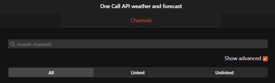

Both the icon and the iconID are available also with the Account thing, Go to the channels page and tick Show advanced, it should discover the iconID for every forecasted time interval
Thank you @hmerk for your quick reply. I know that I have to use oneCallApi… but iconID is not included only Icon as image … this may have changed … or can it be configured somehow?
Thank you @Dest “show advanced” make the difference. Thank you for the solution!
Thanks @hmerk and @Dest for clarification, you were faster than me :slight_smile:

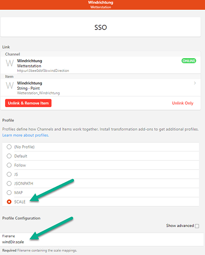

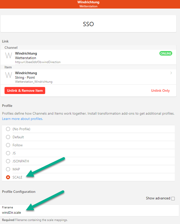

@BG56: I see your wind direction is showing in degree. I’m using a SCALE transformation to have cardinal values.
conf/transform/winDir.scale
[0..11.25] = N
]11.25..33.75] = NNO
]33.75..56.25] = NO
]56.25..78.75] = ONO
]78.75..101.25] = O
]101.25..123.75] = OSO
]123.75..146.25] = SO
]146.25..168.75] = SSO
]168.75..191.25] = S
]191.25..213.75] = SSW
]213.75..236.25] = SW
]236.25..258.75] = WSW
]258.75..281.25] = W
]281.25..303.75] = WNW
]303.75..326.25] = NW
]326.25..348.75] = NNW
]348.75..360] = N
[..] = na
NaN="N/A"
PS: your weather forecast looks somewhat as bad as mine :frowning:
Thank you @Integer (Mike) for your hint. I have tried the SCALE setting in Main UI before but it didn’t work and I thought it is a general problem as described at OH 3 Scale profile exception while formatting value - #8 by icompas
You use the item for current wind direction from your weather station. Your item has item-type “String”. For the current wind direction I use the item which was created from the OneCallAPI. This item has item-type “Number:Angle”.
Inspired by your reply I changed the item-type of this item from “Number:Angle” to “String” and now the SCALE transformation works. There are so many little things to learn … which you can’t find in the documentation but only in the forum. Thank you for your help!
