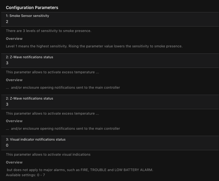

@chris I just tested the new main UI on my ZWave devices. The first thing I noticed that the parameter 2 on my FGSD002 smoke detector appears twice in the list:
Is this an error in the ZWave database or in the main ui? Sadly I cannot access your ZWave device list anymore.

I updated the database to remove the duplicate parameter.

I assume that this has been there a long time - it was in both versions of the device, so probably has been there since the beginning and no-one noticed
