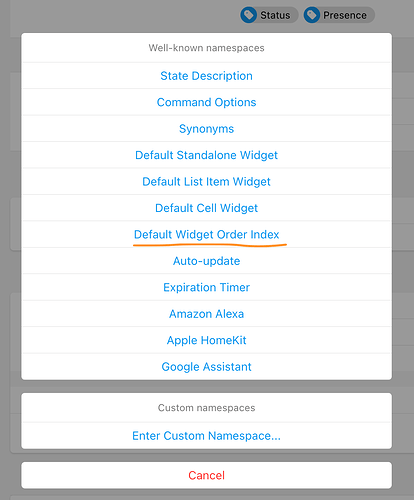

I am working to get my MainUI location cards setup how I like it. I have found how to reorder the cards in the locations tab and get custom list widgets for the points. I can’t find how to reorder the equipment or points within each equipment on the cards. Is there a way modifying the order of Equipment and Points that appears on the auto generated location cards? Or is this something that would have to be done in my own pages?

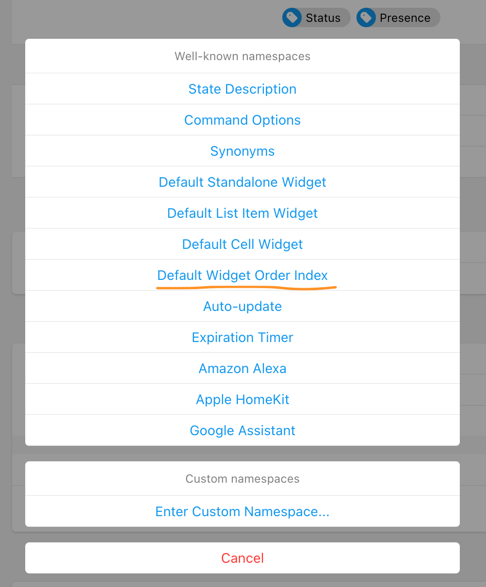

On the Point Items you can add “Default Widget Order Index” metadata to control the order.
