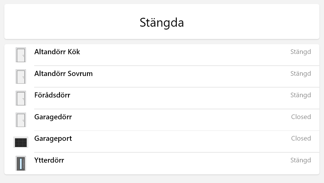

OH3 MAP transformation is behaving different for different Items
I have some door items zwave and verisure and MAP does not work for zwave items
Contact    StoreRoom_Door_State       "Förådsdörr [MAP(se.map):%s]"          <door>          (geStoreRoom_Door, gcDoors, gpCR)     ["OpenState"]    {channel="verisure:doorWindowSensor:liegatan:2JJSRTUB:state"}
Contact    Kitchen_Door_State         "Altandörr Kök [MAP(se.map):%s]"       <door>          (geKitchen_Door, gcDoors, gpCR)       ["OpenState"]    {channel="verisure:doorWindowSensor:liegatan:2JJSTVU8:state"}
Contact    Bedroom_Door_State         "Altandörr Sovrum [MAP(se.map):%s]"    <door>          (geBedroom_Door, gcDoors, gpCR)       ["OpenState"]    {channel="verisure:doorWindowSensor:liegatan:2JJGCK67:state"}
Contact    Garage_SideDoor_Contact    "Garagedörr [MAP(se.map):%s]"          <door>          (geGarage_SideDoor, gcDoors, gpCR)    ["OpenState"]    {channel="zwave:device:e8581bab06:node18:sensor_door"}
Contact    Garage_Gate_Contact        "Garageport [MAP(se.map):%s]"          <garagedoor>    (geGarage_Gate, gcDoors, gpCR)        ["OpenState"]    {channel="zwave:device:e8581bab06:node20:sensor_door"}

This is what the ui shows
Those labels defined in the .items files are only used in sitemaps. To change the way the state is shown in MainUI you need to change the State Description Item metadata.

What’s different between the Garage door Items that do not seem to work and the door Item that do appear to work? Perhaps there is a typo? Your screen shot shows it working for some of your Items so the solution is in figuring out what is different.
The two that are not working are zwave items vs verisure. Are the z-wave node channels returning Open or OPEN, Closed or CLOSED

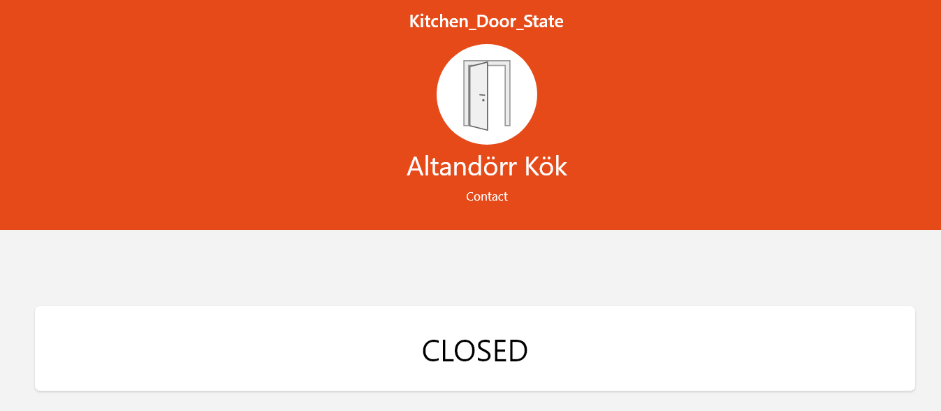

Verisure without MAP
Contact    Kitchen_Door_State         "Altandörr Kök"       <door>          (geKitchen_Door, gcDoors, gpCR)       ["OpenState"]    {channel="verisure:doorWindowSensor:liegatan:2JJSTVU8:state"}

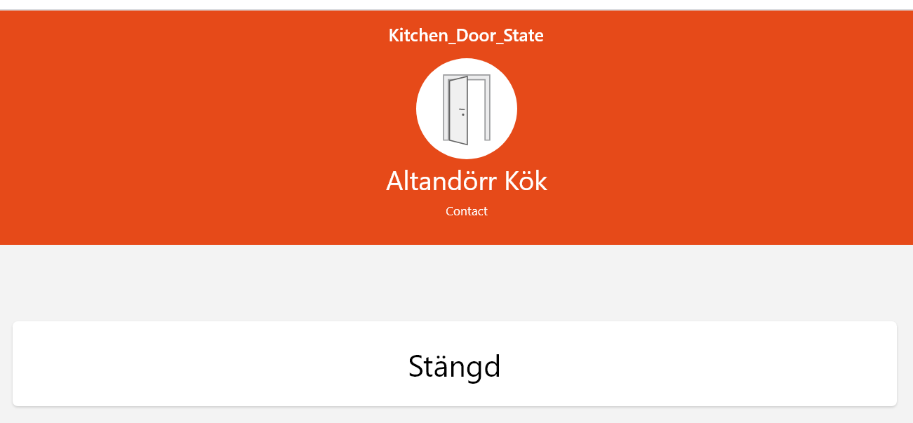

Verisure with MAP
Zwave without MAP
Contact    Garage_Gate_Contact        "Garageport"          <garagedoor>    (geGarage_Gate, gcDoors, gpCR)        ["OpenState"]    {channel="zwave:device:e8581bab06:node20:sensor_door"}
Zwave with MAP
