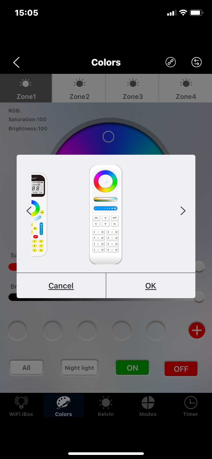

Under the Homebridge and with the remote control everything runs as desired.
What I noticed is that in the illustration for the iBox2 the baud rate is always displayed with 9600.
This cannot be reduced for me and comes up with 38400. Could this be causing my problems?
