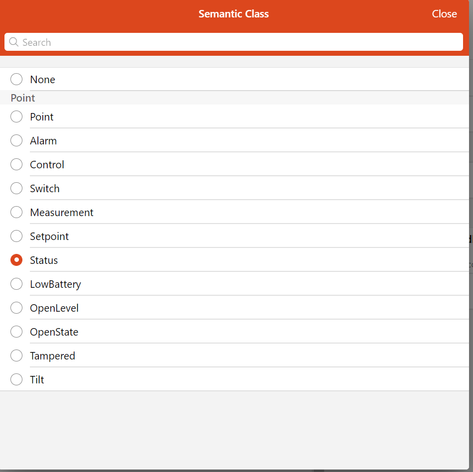

This link might be useful for you to check your configuration.
Lightbulb is an Equipment type , so you’re essentially telling openHAB ‘this is a group Item’ when you use the Lightbulb tag. Equipment Group Items don’t have Properties.
For Properties to work it needs to be a single Item, most often combined with a Point. Hopefully it’s clear in the link above!
EDIT: Removed misleading info.
Properties go with Points and it defines the “what” of the point. For example, if I have a temp sensor I’d define “Measurement” for what the Point represents and “Temperature” as the what, i.e. what is being measured. A humidity sensor would be “Measurement” for the Point and "Humidity for the Property, what is being measured. If I have a light switch I’d have Switch as the Point and “Light” as the Property, i.e. what the switch controls.
Either you are not adding Properties to your Point Items or there is something wrong about the way you are defining the tags.
Take MasterBedroomDimmerGroup. You have it tagged as Equipment, which is OK. But LightBulb is probably a better choice for an equipment tag.
MasterBedroomDimmer is a Point Item and a member of the above Group. You have it tagged as Lighting for the Point and LightBulb as the Property. But there is no Lighting Point tag. There is no LightBulb Property tag.
This is the full set of allowable Point tags:
[rant] And this is why I stopped supporting .things files and pretty soon may have to stop supporting creating the model in .items files. How much time have we all spent on this so far when if it were just done through the UI in the first place it’s obvious and apparent what goes where.[/end rant]
Given this is a Dimmer, I would probably define it with Setpoint as the Point tag and Light as the Property. Here’s your list of allowed properties:

If it’s not in the above list, it’s not a Property tag. A Property tag can only appear after a Point tag (no properties allowed on Equipment nor on Locations). Locations are always a Group. Equipment is almost always a Group.
MasterBedroomDimmerSwitch Get rid of this Item. You don’t need it. You can send and receive ON/OFF commands to your Dimmer Item.
MasterBedroomDimmerKWH is a measurement of energy so use Measurement,Energy.
MasterBedroomDimmerWatts is a measurement of energy also so use Measurement,Energy.
MasterBedroomDimmerPower is a measurement of power so use Measurement,Power.
