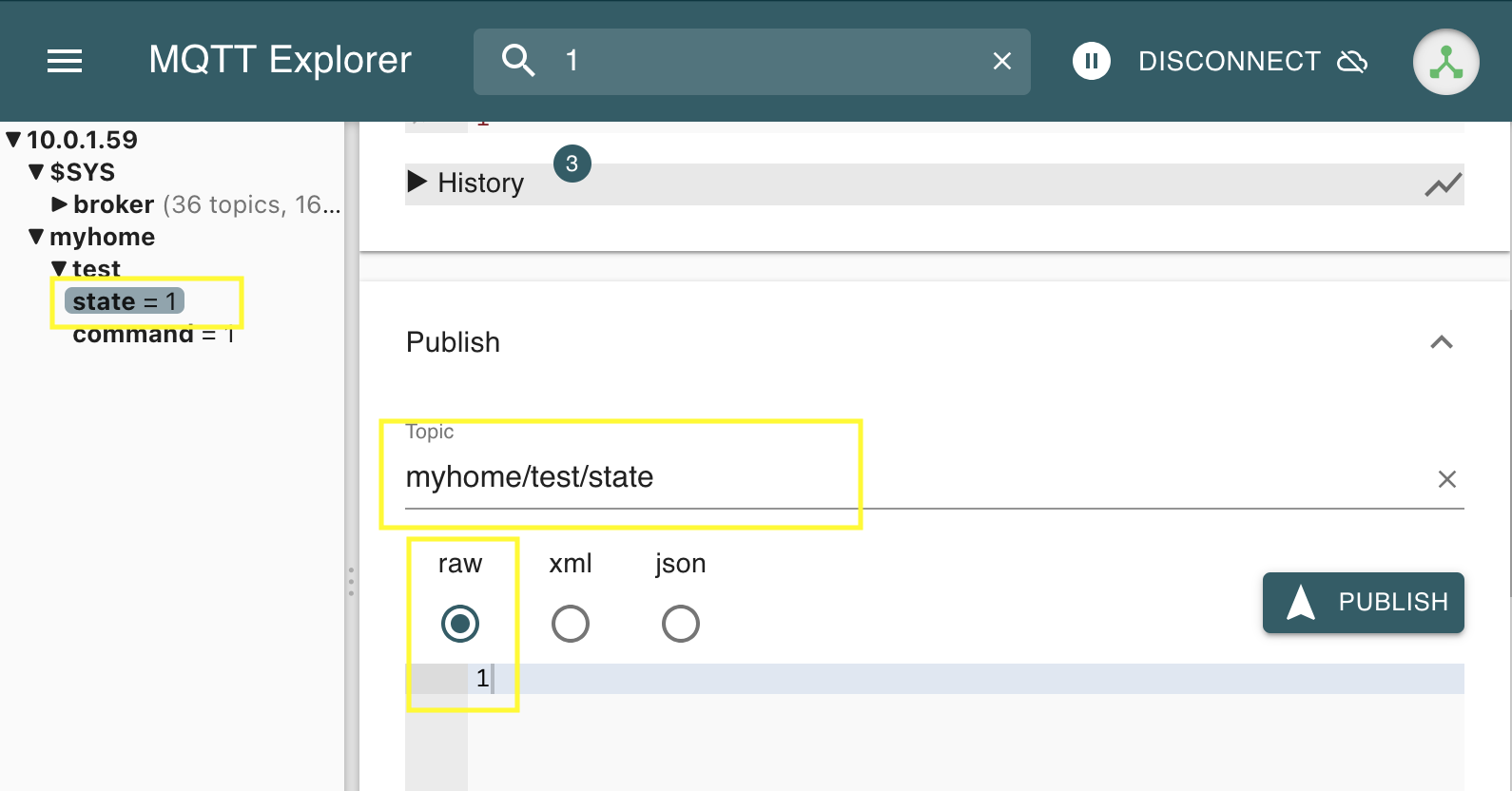

To test sending Mqtt state messages to OH3, I use MQTT Explorer

The transformation MAP error occurs regardless of what payload I send… of “ON” or “OFF” or “0” or “1” are all not processed. result in error.

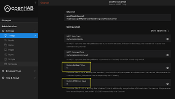

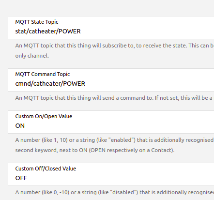

Did you define the on adf off of the thing channel like this:
Thanks, I’ll be home in a couple of hours to have a look.
I’m pretty sure the custom on off values in your screen grab were set at
1
and
0

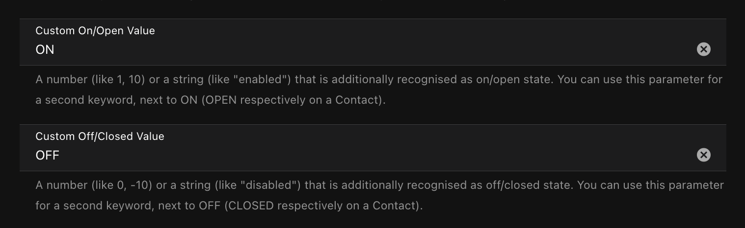

respectively. I’ll have a look and edit them to ON OFF and see if that helps.
They would have been, but I think there’s a bug which means that the configuration isn’t saved properly. If you change the 1/0 to ON/OFF, then save, then change it back to 1/0 and save again it should all work (and remove the transformationPatterns from the configuration: you don’t need the MAP anymore)
Thank you. Your advice was correct, and it does look like a minor bug.
Looking at my Thing, Configure Channel… there was a 1 & 0.
I updated this configuration to ON & OFF
clicked SAVE and retested the Transformation:MAP function.
Inbound MQTT topic messages with payload of “1” & “0” are now being transformed to “ON” & “OFF”.
All is now working as expected.
Thank you!
