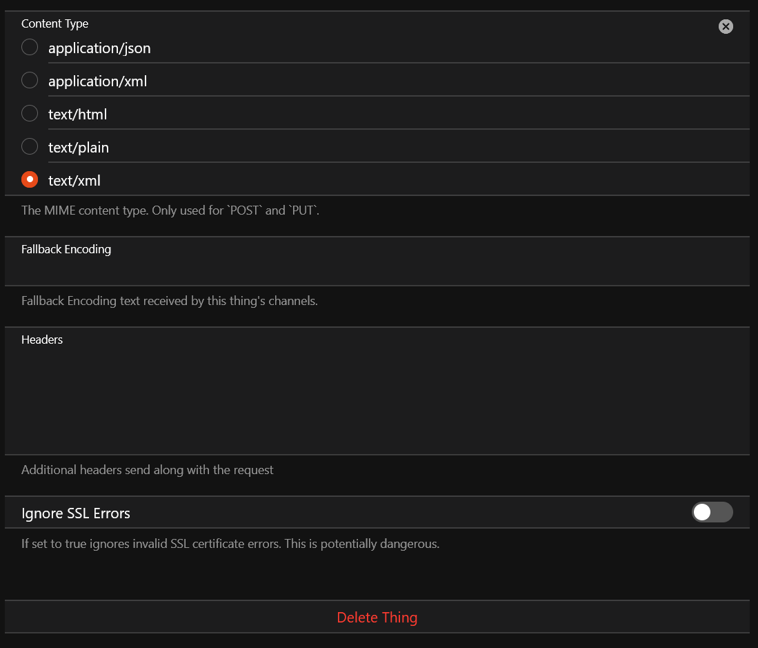

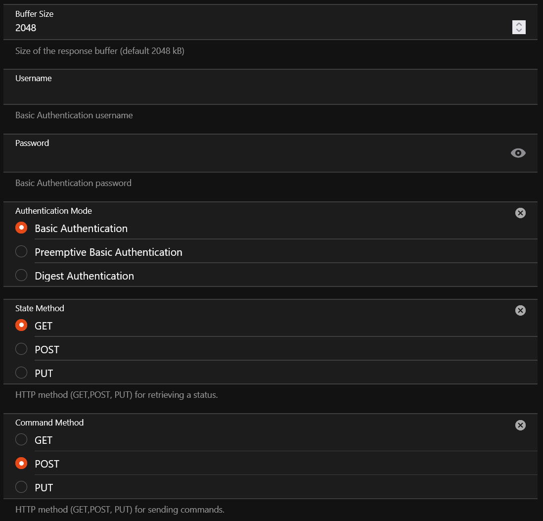

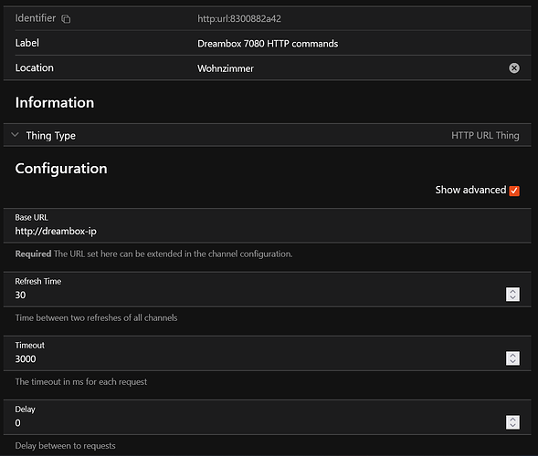

Creating the thing:
Please don’t write “dreambox-ip” but your actual IP of the receiver :wink:
Also here I just insert the base-adress without the “/web/downmix” part.

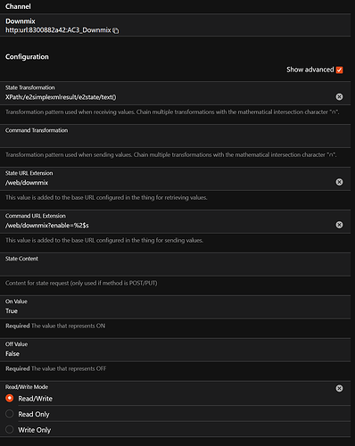

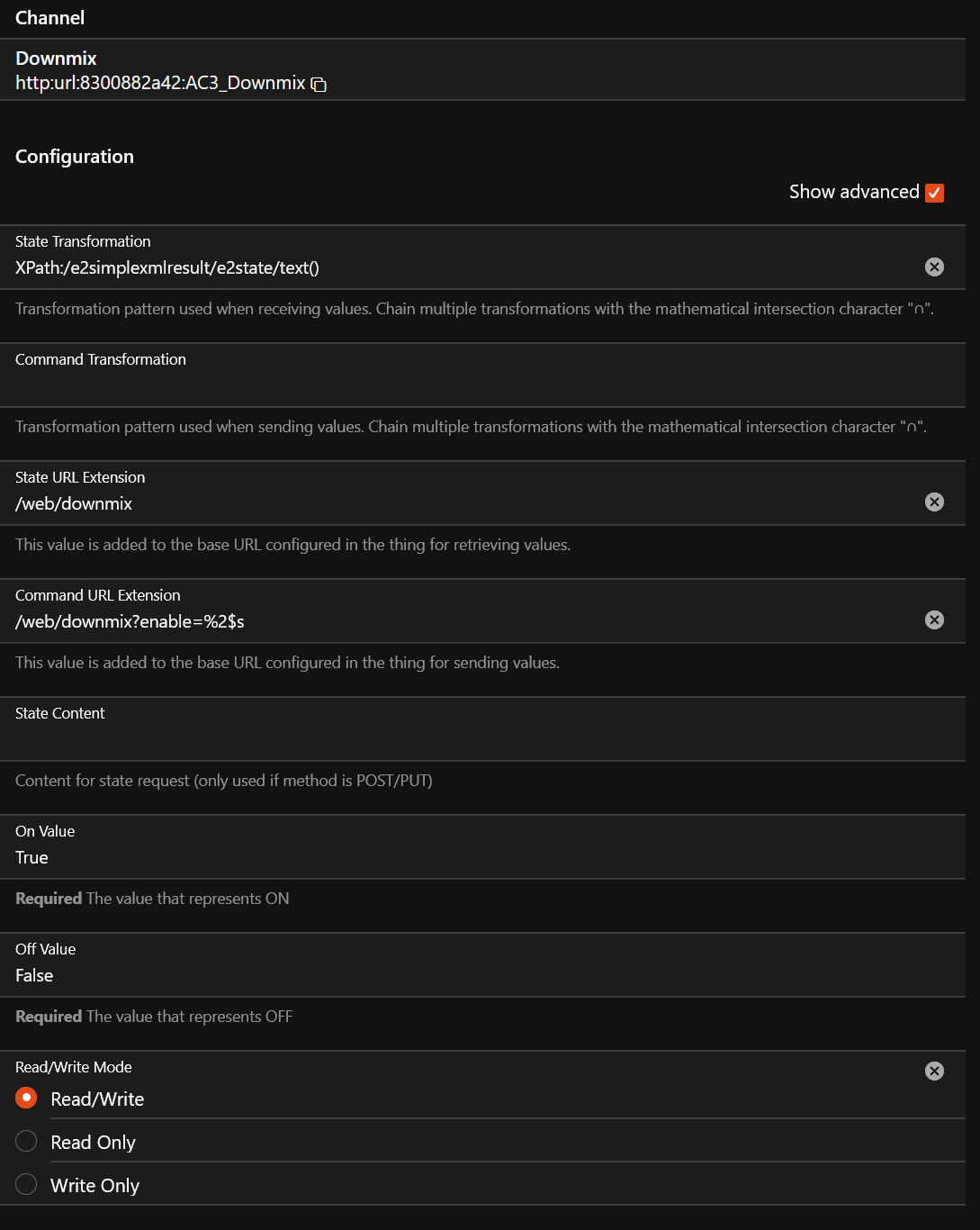

Creating a Switch channel for the thing:
Under Channel Add Channel or Configure Channel (if you’re just editing an already created one) the configuration looks like this.
The XPath-value will navigate the response XML to read the current state.
To read the current state we’ll just need /web/downmix without the ? and everything past that.
The command URL extension of course needs the part including enabled= and the parameter %2$s which contains either the onValue or offValue. We’ll also define that the onValue is True (case sensitive btw. so true or TRUE won’t work with enigma2)
