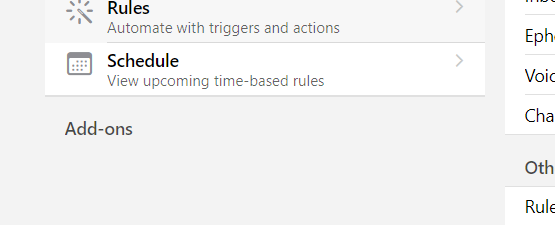

When running oh3 in Eclipse the add-ons section is missing in the UI

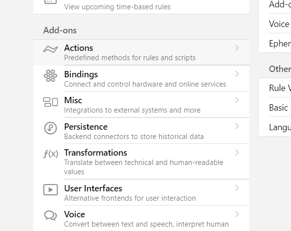

when running regular build I can see the addons section and can edit the binding config.
Note, also tried to directly edit the userdata/config/bindingname.config file, but that did not work
any suggestions?
