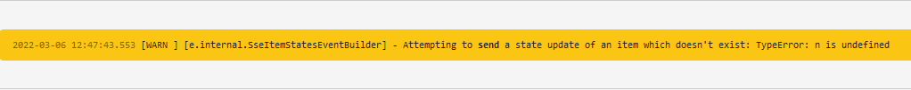

And yet, when I click on the Button, i only get the following Message:
in written Form:
[WARN ] [e.internal.SseItemStatesEventBuilder] - Attempting to send a state update of an item which doesn't exist: TypeError: n is undefined
Already rebooted the Raspi and tried with different items, Itemnames and whatnot…
I can already guess, that it’s something obvious I’m not seeing here,but…well…I’m not seeing it..
So thanks in advance to everyone who can help me stay sane with this. :crazy_face:

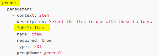

Either you select
actionItem: =props.Item
since this is the item defined in the properties section,
or you just write
actionItem = TestItem
if you want to have it static and not selectable with the widget’s properties
Alright, got it to work.
It seems I was so focused on the slots-part, that i compleatly missed the props…
