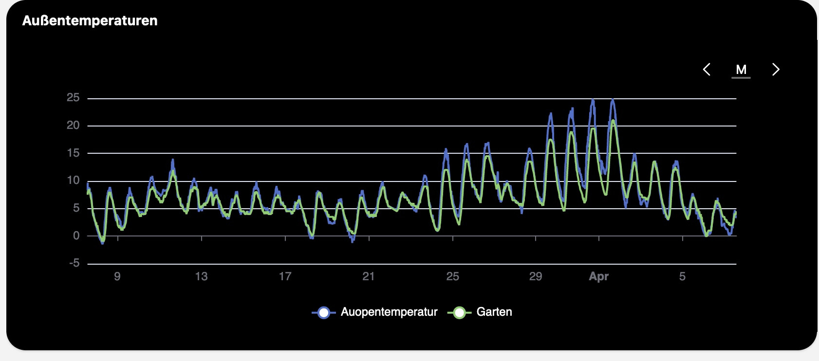

Just fiddling around a bit with the new oh-chart possibilities and the using them as a widget instead of a page.
So far, it works good,

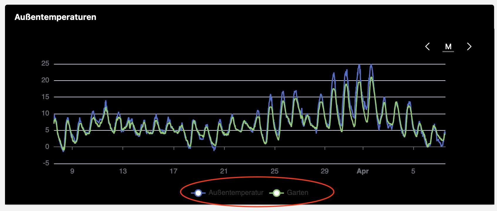

I just try to change the text color of the legend. According the eChart documentation this should be possible.
I tried to insert this into the legend definition, but without any effect.
        legend:
          - component: oh-chart-legend
              show: true
              orient: horizontal
              bottom: "8"
              textStyle.color: '#FFFFFF'
Is this implemented in OH3, or has anyone an idea how to do it right?

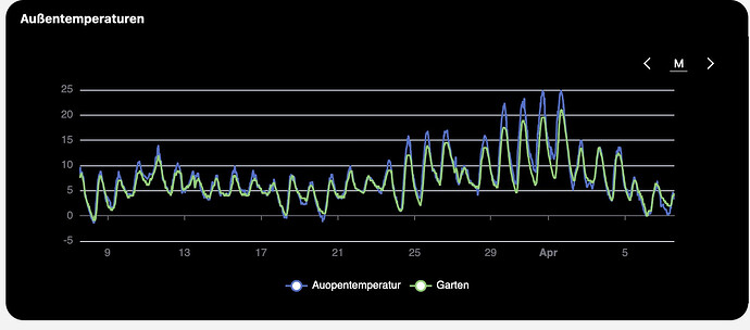

This post was too quick. Found the solution, and changed the config like this:
legend:
              show: true
              orient: horizontal
              bottom: "8"
              textStyle:
                color: "#FFFFFF"
