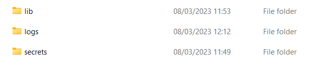

The initial start using the start.bat file works as expected, with no extra folder/directory created:

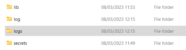

However, aftre following the steps to create a Windows Service, and when using the created service to start openHAB, an extra folder get s created called C:\openHAB\userdata\log, should be C:\openHAB\userdata\logs.
The spurious folder contains an openhab.log file but the size remains at 0bytes.

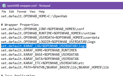

It seems that’s the default Karaf Log folder is created as /log under the Karaf Base folder. In this case the base folder is C:\OpenHab\userdata which is set in the /etc/openHAB-wrapper.conf file
The problem is the Default Karaf log folder is not set in that config file so stays at the /log default.
I added the line below to the wrapper config after %OPENHAB_USERDATA% is set, Deleted the /log folder and restarted the service.
The folder did not reappear.
set.default.KARAF_LOG=%OPENHAB_USERDATA%\logs
Screen shot below for context.
Try it out and let me know if it works for you.
I think the Docs need to be changed to include that extra line. If the above works for you I’ll do a PR on the Docs.
