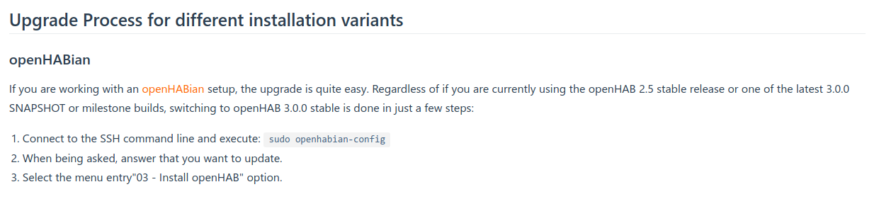

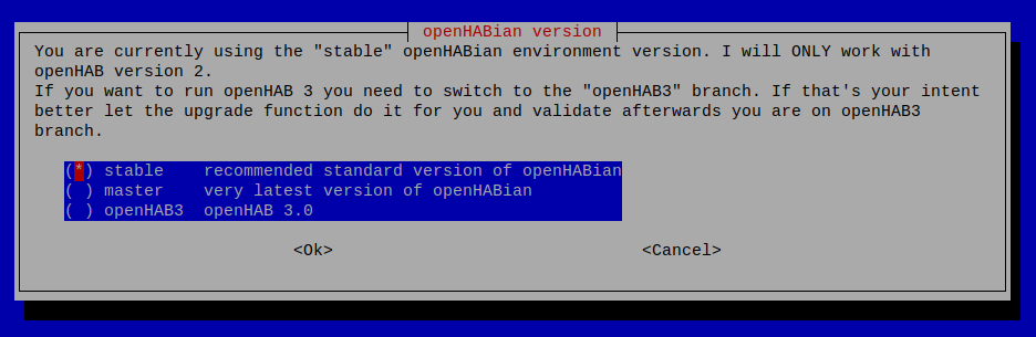

Re-reading the description in the âSelect Branchâ openhabian menu area, it seems perhaps the upgrade function is supposed to automatically select the openHAB3 branch, but it appears that function/feature did not properly execute as it should have.
All fixed and working! I had my /etc/openhabian.conf file open in the background and this apparently caused issues with openhabian properly executing. I kept selecting âopenHAB3â branch but it kept reverting back to âstable.â Once I closed the .conf file, and then selected 3.0 branch and ran the upgrade menu option again it worked without issue. I then ran through all of the âApply Improvementsâ options one at a time and finally the Samba âOptional Componentsâ option and it quickly fixed the samba share locations to /openhab and not /openhab2.
