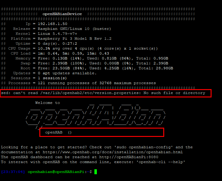

It’s just a static banner output and does not reflect the currently installed openHAB version so you don’t have to do anything about it. It’ll get fixed in a couple of days I guess.
Hmmm…I changed to master and did an update and even upgrade, but nothing really happened:

Are you sure, the right repositories are taken into account?
