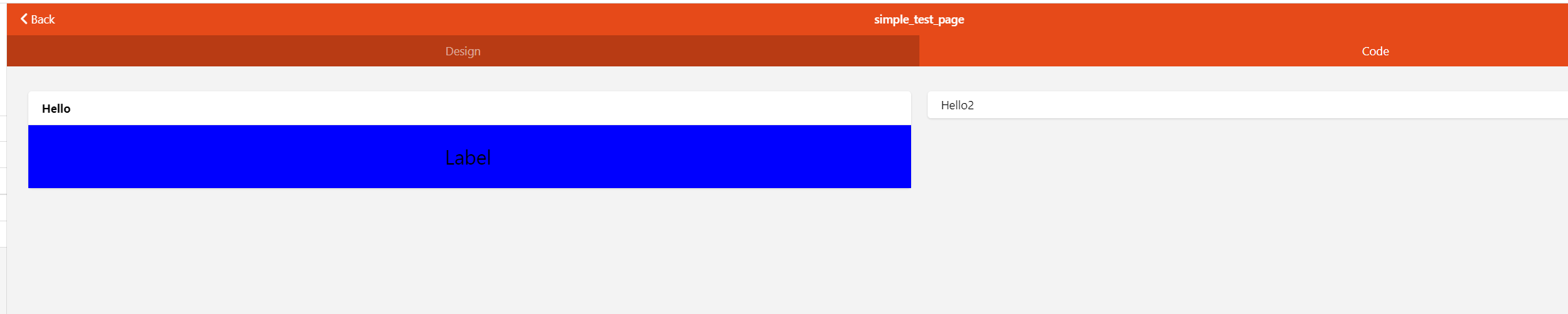

I’m trying to change the background color without success:
Rainer’s code:
  label: "YOURPAGE"
  sidebar: true
  style:
    background: linear-gradient(to top left,#151924 0%,#393F4D 100%)
doesn’t seem to work with my pages; neither with linear-gradient nor a simple color name like yellow (lines 4&5). Any ideas why?
  label: simple_test_page
  sidebar: true
  style:
    background: yellow

All this gets is:

Very strange, I just don’t get it to run. Apart from a simple name like ‘red’ I tried both your versions but the background-color of the page doesn’t change. They do work, however, in the background of a label-item:
Here’s the code:
  sidebar: true
  style:
    background: linear-gradient(to top left,rgb(21,25,36) 0%, rgb(57,63,77) 100%)

Does it have something to do with the position of the command?
line 4/5 - config and style vs line 22 - directly config, no style
I tried line4 without config without success, so probably not …

Save the page and have a look at it in live view - it might possible that the styles won’t get applied within the “run mode” preview, which would be a small bug. → You could open a issue at the openhab-webui github repo then

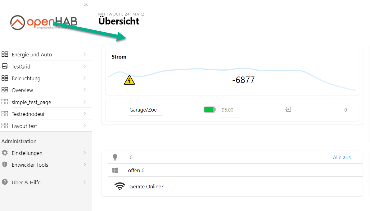

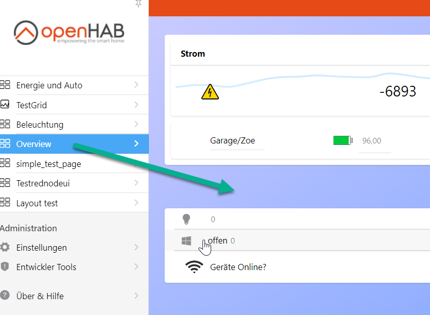

I’d like the homepage (the one that appears when clicking on the OH-symbol to the top left) to have a background, too.
I can set a background to the ‘overview’-page and it works when this page is opened directly. But when I open the homepage where it’s integrated, there’s no background.
I tried to set a background to the homepage itself, too. But that doesn’t have any effect:

No background at “homepage”
vs. background when opening overview directly:
its not possible to have a custom background on the overview page unfortunately. I am not sure if this has already been requested as enhancement request. In summary there are some restrictions on backgrounds in general e.g. vs. widgets. I hope this will be picked up by the development team over time.
thanks for the information, good to know.

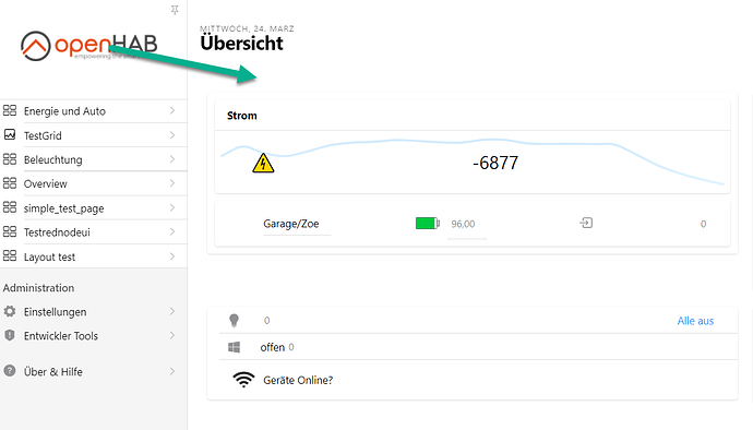

Building on your example I’m getting closer to the look I’d like to achieve:
However, there two problems:
  • there’re some white space left
  • the color of the header and the label card are defined idtentically (“#e6e6e6”) but look differently (label card is brighter).
Here’s the code (I tried to make it simpler (like in your other example) but failed miserably ;-), but probably not relevant for the current problem )

It’s hard to figure out, which ‘white space’ you’re referring to. You’re writing left but the arrow in your image is pointing at the card background, which is visible on three of the four sides.
Most of the component have a padding / margin to prevent collisions with elements around them and making it usable and good looking on multiple devices and in most of the common use-cases. As you’re using cards in cards here this padding / margin gets multiplied.
But I don’t think this is the real problem here… You just want the whole card to be coloured in this lightgray color. Why not applying the background-color to the f7-card element then, instead of doing it in every component?!
Each component inside that card, which not accept css styles like ‘background’ (like the oh-label-card for example) have to be treated separately. To see the available config parameters for that component you could either use the editor-tooltips or read the docs → oh-label-card - Label Card | openHAB
That is the obvious solution to what I want to achieve. I just didn’t think of it because I tried to transfer your other tip (title colors) to this question, which wasn’t a good idea of mine. That just proves your first point that I should try to “understand what I do and how everything works together” :wink:
