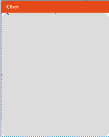

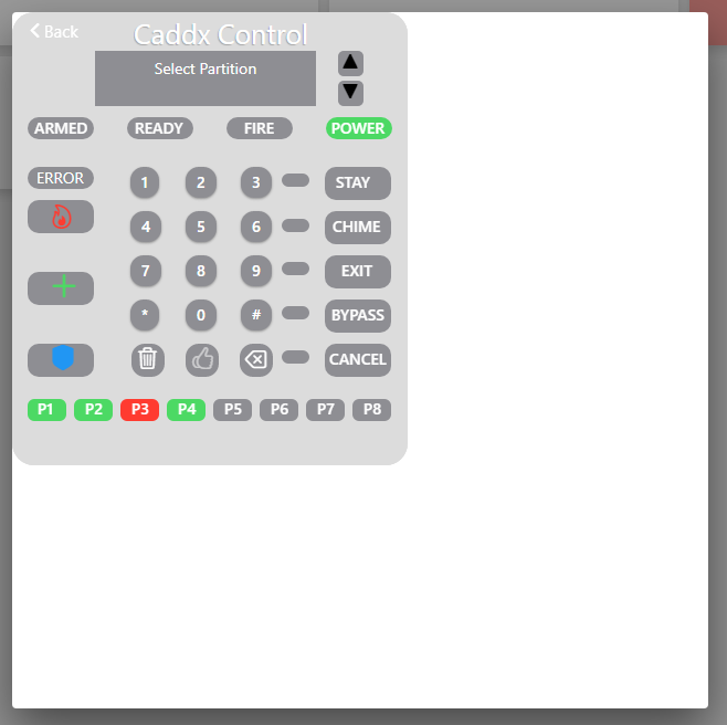

The result is (on a PC Browser (Chrome):
The issues I have:
  1. The popup size is larger (in this case) than the defined page - leaving all the surrounding space.
  2. The NAV bar overlaps the actual page - have tried the options to hide the NAV bar - but don’t get any workable results:

Managed to get a “workable” popup solution, in full as below:
Managed to get rid of the NAV Bar etc.

Hi Greg
Yes, I spent a couple of hours after your suggestion trying that (I did not change EVERYTHING to %, just position. Sizes etc have been left as px:
New Widget
Definitely more scalable, though there are limits:
The alignment can look perfect on the preview - but very different on the end device
There is still all the “wasted” space at the bottom. The whole layout looks wrong if I try and fill that - especially since trying to look similar to the NX-148E keypad.
The landscape vie on a mobile is completely wrong, even though the portrait view is fine:
Work in progress… So will keep at it.
