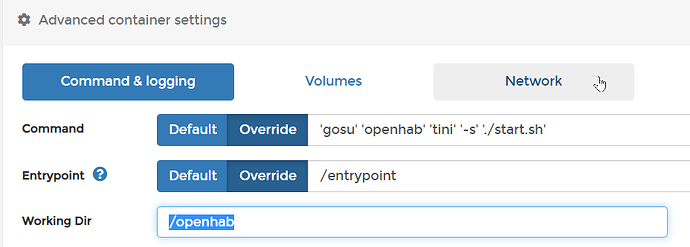

Please find attached pictures of the portainer configuration where I have followed the instructions from the OH3 documentation.

What I see is you are assuming start.sh is in whatever directory Portainer chooses. The error indicates it is some place else.

On my pure OpenHAB-Container using Portainer, the Working-Dir is /openhab and not /opt/openhab
Maybe that is something you can check.

You were right. Changing the Working Dir as suggested worked. No more errors.
