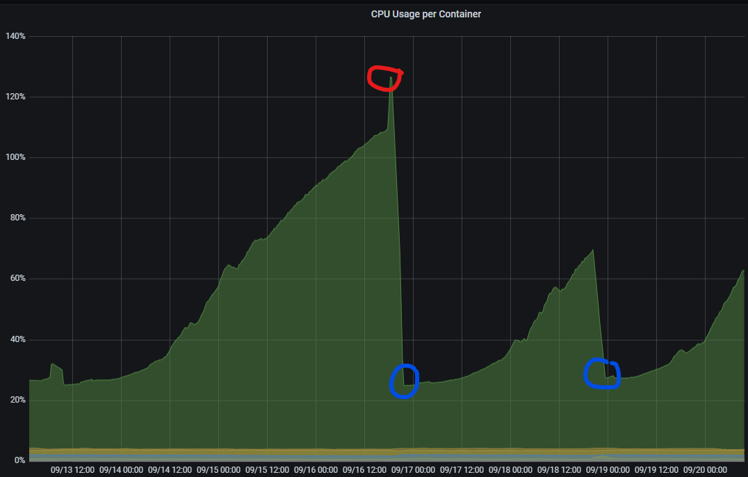

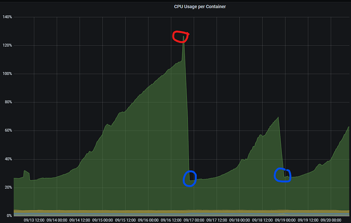

For some reason my openhab3 container keeps increasing in cpu load over a long period.
The blue circles are reboots of the openhab container.
The red circle was when my openhab was unresponsive (sitemaps and pages work but no reponse back from items & things)
Is there a way to debug rules/items/things/… on performance ? Or analyse them ?
I tried removing rules and checking how the system response, but it is a very slow method (takes ± 18 hours to clearly see increasing cpu)
Also updated the system from 3.1.0.M5 → 3.2.0.M2
But same issue occures.
The logging looks normal, and my disk I/O also.
Is there a possibility I have a memory leak in a rule or in a thing ? How can we detect these and what are common mistakes ?
