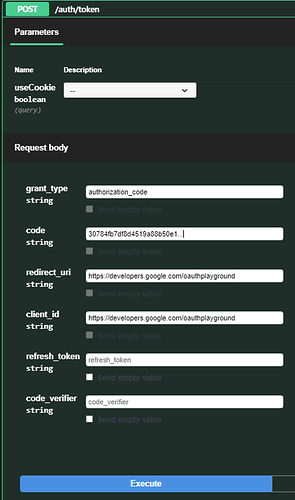

When you come back copy the authorization_code and use the API explorer in openHAB to get your access_token and refresh_token (uncheck the last two “send empty value” checkboxes).

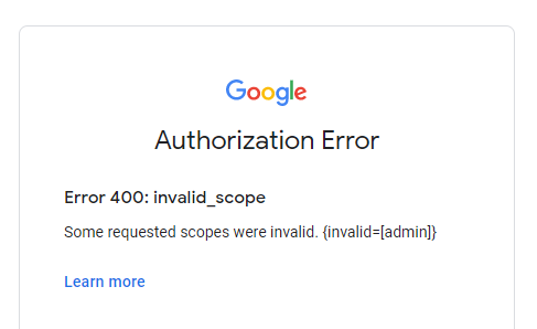

Does not work
When I click the button
I get this
