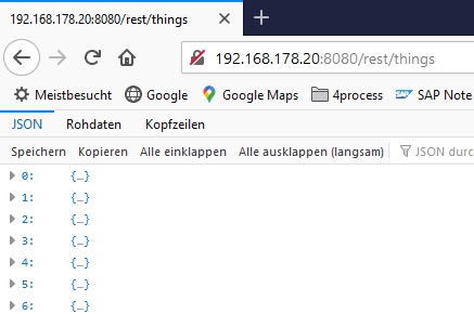

It seems that for example GET/things is not protected by authentication, even without sending auth data the OH server returns all things. This can also be reproduced by a simple browser call:

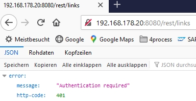

Other methods like GET/links however seem to be protected, they work when passing auth parameters but not with a simple browser call:

I would expect that would be needed for unauthenticated users (currently non-Admins) to be able to read the Thing channel data. I believe the intent, at this point, was to require authentication for write access.
But my 2 examples are both of type read access. One is open without auth (get/things) while the other read acces is blocked by auth (get/links). This does not make sense to me.
A fix for this was merged 3 days ago: [REST Auth] Remove user access to things by ghys · Pull Request #1807 · openhab/openhab-core · GitHub
According to https://ci.openhab.org/job/openHAB3-Distribution/ build #2028 is 5 days old.
You’re not current enough :grinning_face_with_smiling_eyes:
