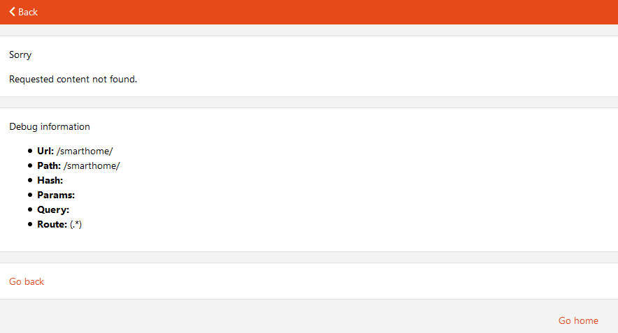

However this is not working. If I navigate to http://myserver/smarthome i can only see a blank page. Network pane shows the following:
immagine

After messing around and wasting many hours I ended up thinking this is not possible in OH3.
I will use a subdomain even if this is not what I wanted to do.
Read this post, for basicUI and the REST API in OH3.
It works fine for me. I don’t need the mainUI at this point though, so you might have to do some additional tweaking.
