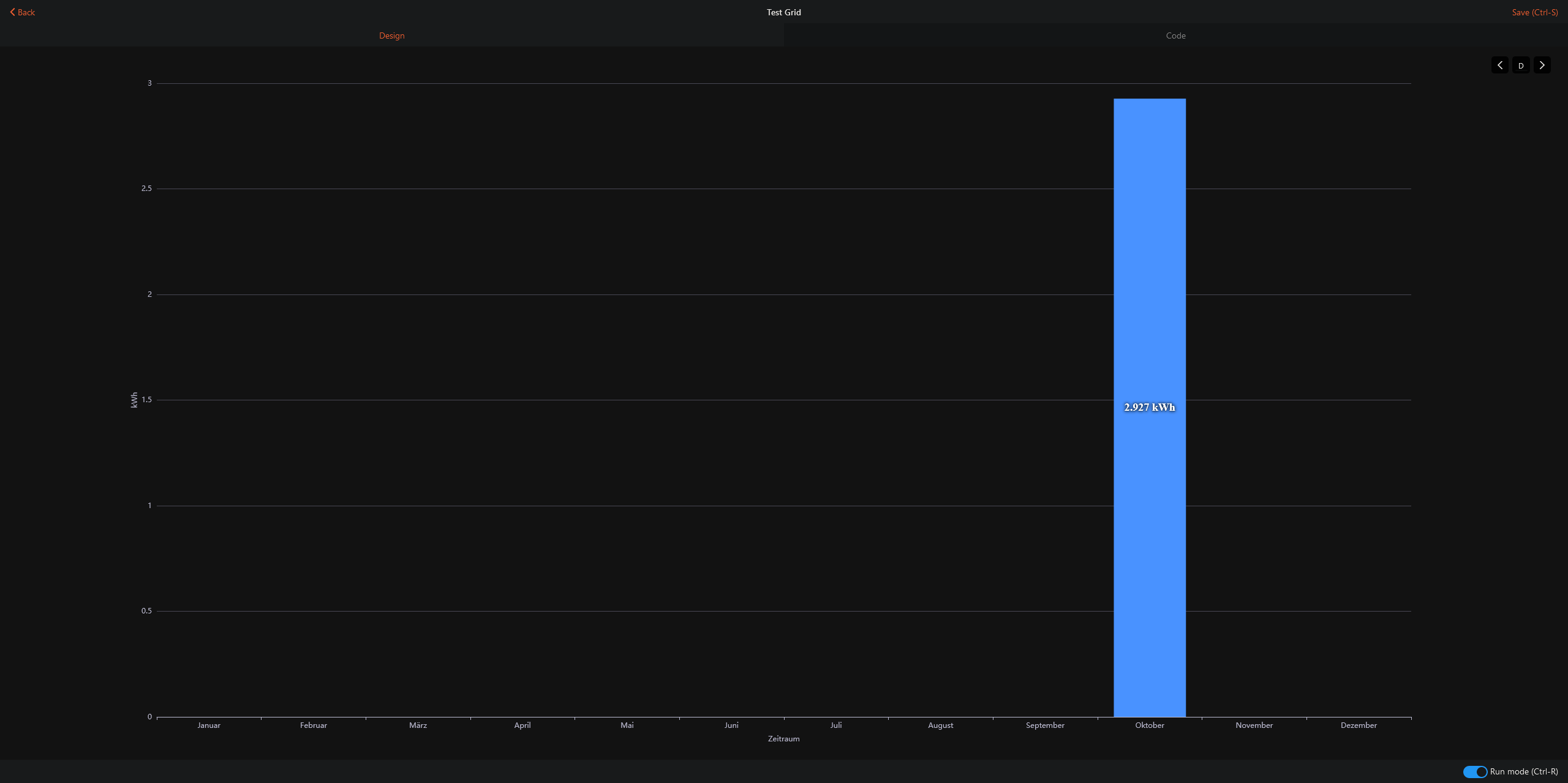

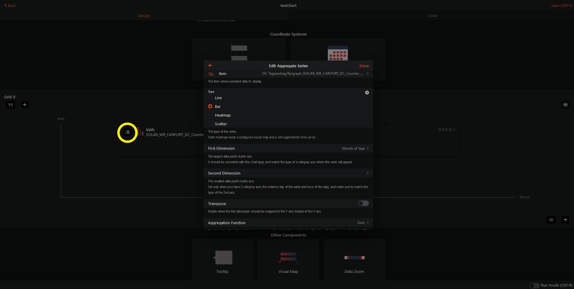

Hello, i’m trying to setup a bar graph that shows the harvested energy for a year in monthly columns.
I’m using rrd4j as persistence service and the internal charts (echarts) as i don’t want to use influx and grafana.
My solar inverter gives me total energy harvested ( an ever increasing value in kWh )
and daily energy harvested ( resets to 0 every morning in kWh).
I’m persisting both with the default rrd4j strategy which is datatype “GAUGE”.

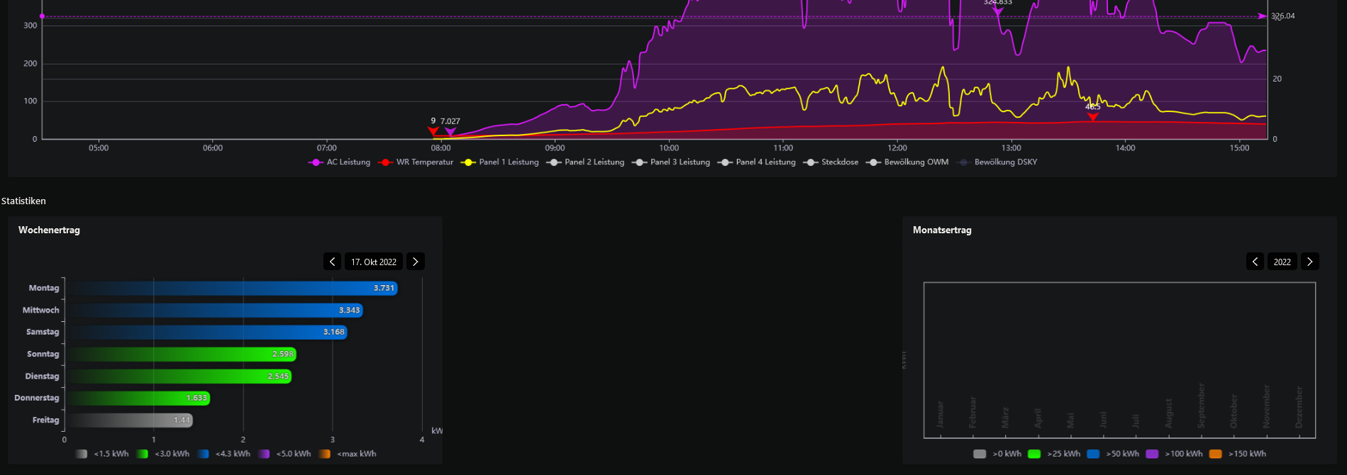

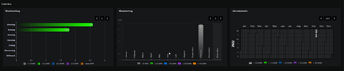

For the weekly bar chart (days of the week), im using the dailyharvested energy item from the inverter with the aggregation function “last”.
It works nicely,as seen in the picture. ( If someone knows howto swap the . with a , and howto round to 1 decimal, pls let me know. Precision: 1 (as written an the echarts docs is not working))
However when i try to do draw a bar graph for “months of year” it won’t work, because
the aggregation function “last” for months of a year will only pick the last value of month which would be in my case the last value of the last day in that month. So the aggregation function is correct but how to solve that scenario?
I’m missing an aggregation function that does something like sum(“last” from all days in dimension1 (e.g. months in a year))
OR if the default GAUGE datatype is used (on a ever increasing kWh counter) → sum(“derivative” from all days in dimension1 (e.g. months in a year))
While reading the docs i found the RRD4J Datatype “COUNTER” and set up an test item using the consolidation Function “TOTAL”
As far as the docs tell me COUNTER is persisting the difference between 2 reads.
So for example if the last value is 57.0 kWh value and the present value is 57.8 kWh, rrd4j should persist 0.8 kWh ( or 8,0000000000E-01 in the rrd4j row)
That way it would be possible to use the aggregation function “SUM” in the charts to sum up all the little bits and get a nice bar chart for that given timeframe (months in a year).

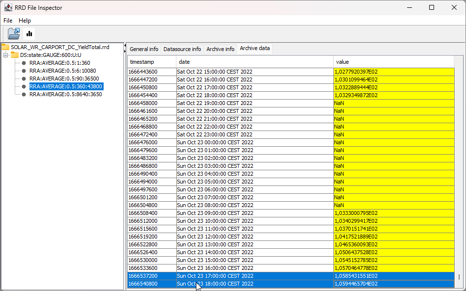

The value of the total counter was 105,98 kWh last evening.

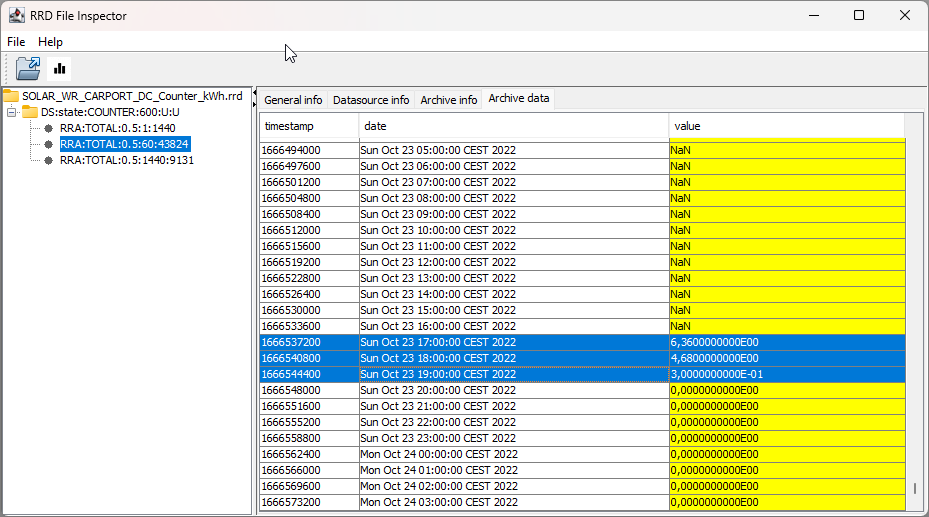

Here is the corresponding rrd with default persistence settings and the correct total counter (GAUGE|AVERAGE):
105,98 - 105,85 = 0,13 Wh. ~0,13 should be the result of the COUNTER|TOTAL RRD item in that timeframe 17:00:00 - 19:00:00. So let’s check the COUNTER|TOTAL RRD item:
The consolidation function TOTAL is also doing the right thing from the first archive minutes to the second archive hours. 6,36 + 4,68 + 0,3 = 11.34. 11.34 kWh is way to much compared to the expected value of ~0,13. It looks like COUNTER|TOTAL is already off by factor 100 even in the first archive.
The bar graph setup seems to be correct. The reading/visualisation/graphing part + setup should be fine as is. I’m getting the same value as in the COUNTER|TOTAL RRD perstistence db from above while using the aggregation function SUM in the chart options of the aggregate series.

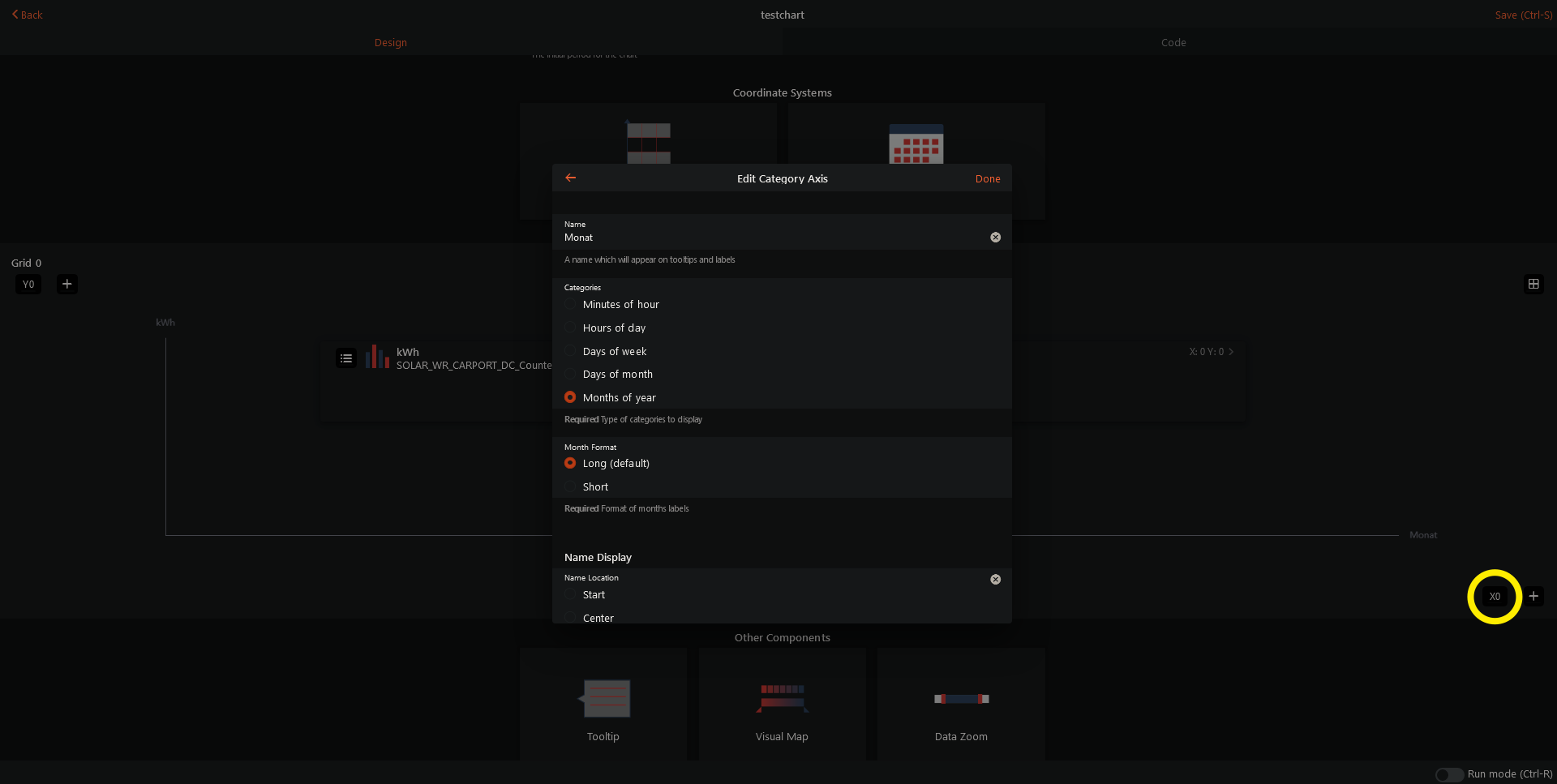

Here is the setup of the chart in case someone wants to do the same:
Let us see what the actual setting is doing before changing the settings.
It would be interesting what the COUNTER:TOTAL rrd file would show in archive 1. That way we could tell what rrd4j is really doing. Comparing the values with a difference calculated from AVERAGED values will not give the correct picture.Additionally remember that first value stored by a COUNTER has to be misleading as it has no correct previous value. This initial value however is used through the other archives for some time.
As I understand your desire you are more interested in the already correctly accumulated data inside rrd4j. That was not the case in the other thread.
Unfortunatly i already deleted the COUNTER:TOTAL rrd file because the values were not correct. But check the third code block in the first post.
I copy pasted the rows from RRD inspector (Archive1 - COUNTER:TOTAL rrd file) over there.

log:set DEBUG org.openhab.persistence.rrd4j
Thx to the increased DEBUG i found out that there were a lot of old rrd4 properties left that i used for testing in the past but they were long gone and not being used anymore so
i deleted the old archive properties inside of the Karaf Console like this:
config:edit org.openhab.rrd4j
config:property-list
config:property-delete kWhsolarCount.items
config:property-delete kWhsolarCount.archives
config:property-delete kWhsolarCount.def
config:update
Next i stopped openhab and deleted all of the old rrd files that are not being used anymore.
This is what my new COUNTER:AVERAGE config looks like:
CounterkWh.def=COUNTER,600,0,U,60
CounterkWh.archives=AVERAGE,0.5,1,1440:AVERAGE,0.5,60,43824:AVERAGE,0.5,1440,9131
CounterkWh.items=SOLAR_WR_CARPORT_DC_Counter_BarChart
I kept my granularity settings. In the first line i switched the min value from U to 0 and switched to AVERAGE for consolidation. That’s it.
I also kept the persistence strategy for that item at “everyMinute” but i switched to “everyChange” in the middle of the night, that’s where it shows NaN from 00:35:00 . I’m not drawing a Line graph with that item anyways. It’s only being used for a bar graph. Persisting zeros through the night is not necessary as i’m only interested in something that is growing the bar. :bar_chart:

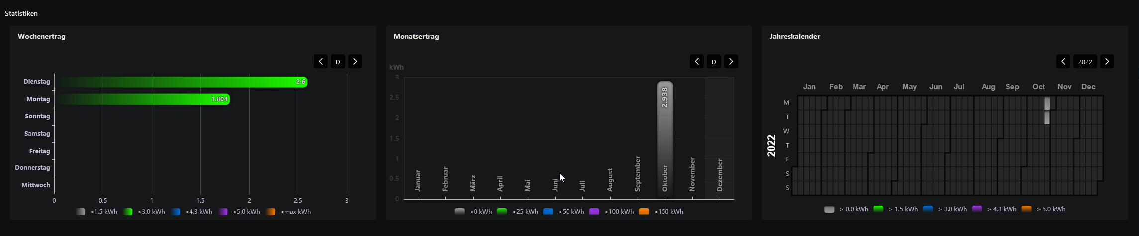

Here’s a pic of the correct values for the last 2 days (Weekly chart, left hand side).
The weekly chart is using the default GAUGE:AVERAGE strategy and this item holds only the total value of the counter from my Solar inverter. Every day it resets to 0.
Bar chart setup:
  dimension1: isoWeekday
  aggregationFunction: last
  type: bar
  item: =props.dailykWh

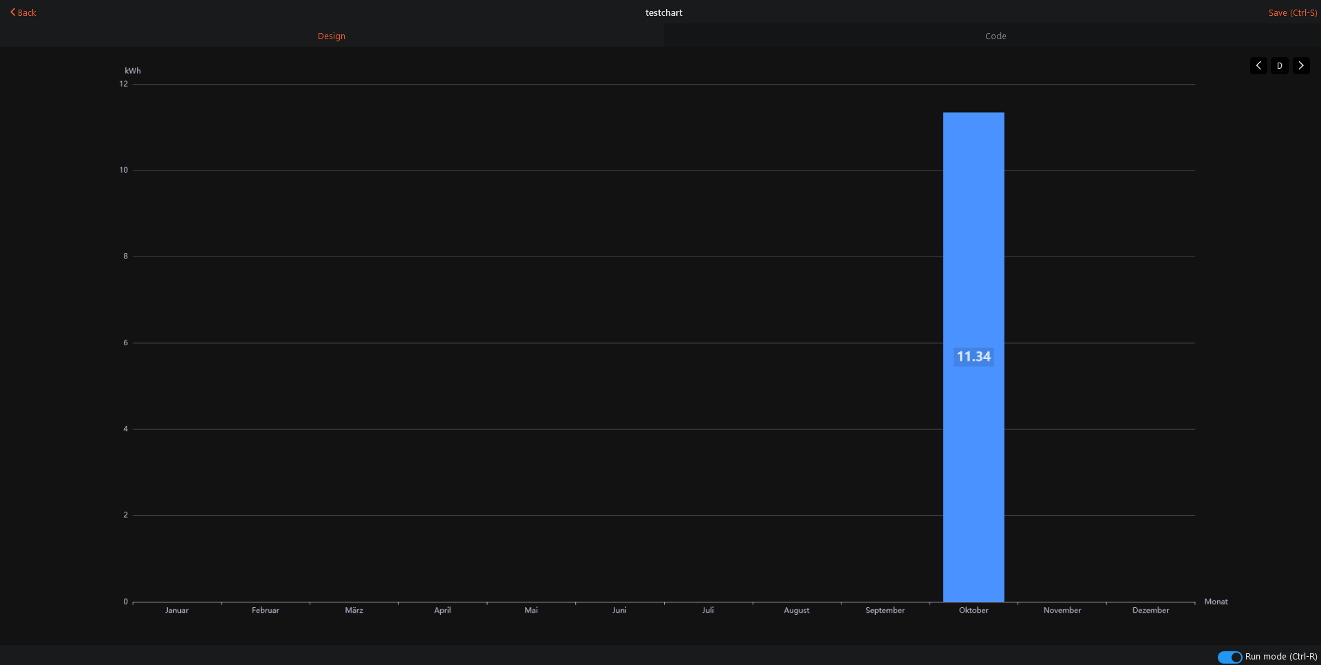

If we sum up both days from the weekly chart we get 4,734 kWh and that is expected to show up in the middle chart. To be continued ^^

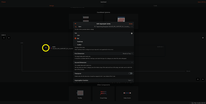

The mothly chart in the middle uses the new COUNTER:AVERAGE item that accumulates its values from the TOTAL Counter of my Solar inverter item.
Bar chart setup:
  dimension1: month
  aggregationFunction: sum
  type: bar
  item: =props.totalkWh

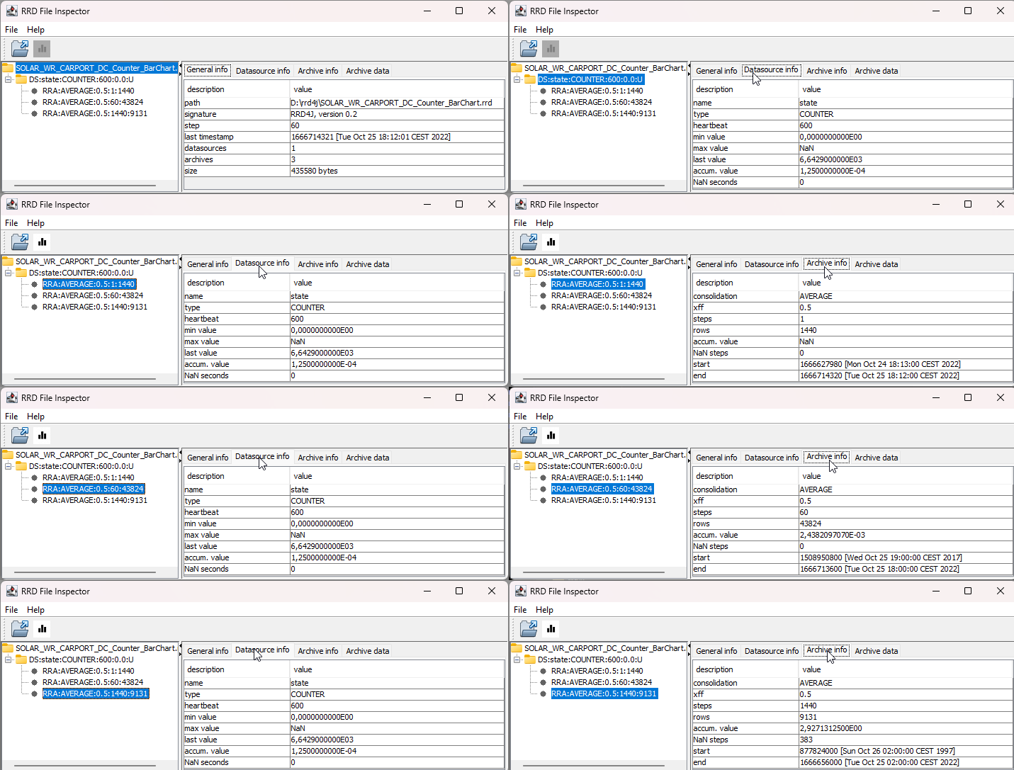

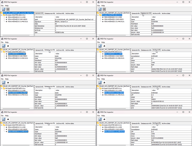

Here is a pic that shows the actual rrd file (rrd inspector):
Archive1 COUNTER RRA:AVERAGE:0.5:1:1440 (RRD Inspector):

Archive2 COUNTER RRA:AVERAGE:0.5:60:43824 (RRD Inspector):
1666591200	Mon Oct 24 08:00:00 CEST 2022	NaN
1666594800	Mon Oct 24 09:00:00 CEST 2022	8,0000000000E-05
1666598400	Mon Oct 24 10:00:00 CEST 2022	1,2500000000E-03
1666602000	Mon Oct 24 11:00:00 CEST 2022	2,0166666667E-03
1666605600	Mon Oct 24 12:00:00 CEST 2022	3,3500000000E-03
1666609200	Mon Oct 24 13:00:00 CEST 2022	4,9666666667E-03
1666612800	Mon Oct 24 14:00:00 CEST 2022	6,3333333333E-03
1666616400	Mon Oct 24 15:00:00 CEST 2022	5,9833333333E-03
1666620000	Mon Oct 24 16:00:00 CEST 2022	2,8500000000E-03
1666623600	Mon Oct 24 17:00:00 CEST 2022	2,4000000000E-03
1666627200	Mon Oct 24 18:00:00 CEST 2022	7,8333333333E-04
1666630800	Mon Oct 24 19:00:00 CEST 2022	6,6666666666E-05
1666634400	Mon Oct 24 20:00:00 CEST 2022	0,0000000000E00
1666638000	Mon Oct 24 21:00:00 CEST 2022	0,0000000000E00
1666641600	Mon Oct 24 22:00:00 CEST 2022	0,0000000000E00
1666645200	Mon Oct 24 23:00:00 CEST 2022	0,0000000000E00
1666648800	Tue Oct 25 00:00:00 CEST 2022	0,0000000000E00
1666652400	Tue Oct 25 01:00:00 CEST 2022	0,0000000000E00
1666656000	Tue Oct 25 02:00:00 CEST 2022	NaN
1666659600	Tue Oct 25 03:00:00 CEST 2022	NaN
1666663200	Tue Oct 25 04:00:00 CEST 2022	NaN
1666666800	Tue Oct 25 05:00:00 CEST 2022	NaN
1666670400	Tue Oct 25 06:00:00 CEST 2022	NaN
1666674000	Tue Oct 25 07:00:00 CEST 2022	NaN
1666677600	Tue Oct 25 08:00:00 CEST 2022	NaN
1666681200	Tue Oct 25 09:00:00 CEST 2022	5,2612612613E-04
1666684800	Tue Oct 25 10:00:00 CEST 2022	3,7894444444E-03
1666688400	Tue Oct 25 11:00:00 CEST 2022	6,9716666667E-03
1666692000	Tue Oct 25 12:00:00 CEST 2022	8,5588888889E-03
1666695600	Tue Oct 25 13:00:00 CEST 2022	9,0572401434E-03
1666699200	Tue Oct 25 14:00:00 CEST 2022	6,8533154122E-03
1666702800	Tue Oct 25 15:00:00 CEST 2022	7,3986111111E-03
1666706400	Tue Oct 25 16:00:00 CEST 2022	2,7902777778E-03
1666710000	Tue Oct 25 17:00:00 CEST 2022	2,2594262295E-03
1666713600	Tue Oct 25 18:00:00 CEST 2022	7,4156888649E-04
Archive3 COUNTER RRA:AVERAGE:0.5:1440:9131 (RRD Inspector):
1666483200	Sun Oct 23 02:00:00 CEST 2022	NaN
1666569600	Mon Oct 24 02:00:00 CEST 2022	NaN
1666656000	Tue Oct 25 02:00:00 CEST 2022	1,8333333333E-03
The values are spot on. I drew a test bar graph of the first log day and it was spot.
This evening i drew another test bar graph ( Days of a week | Aggregate SUM)to check what it’s telling me with the data of 2 days.
It works but the bar of monday kept shrinking and the value is way off (4,734 kWh is the correct value for these 2 days) again as seen here:
Next i switched to another graph strategy ( Month of year | Aggregate SUM) to show the whole month. I wanted to see if my bar is shrinking as well and it did.
Long story short. Archive1 is only 1440 mins aka 24h. It looks like the SUM Aggregation function in the page chart options is only reading the first archive of the rrd file.
I thought changing the aggregation timeframe helps and it will do better, but möööööööööööpp :D. The bar keeps shrinking. It’ll only aggregate the sum of those 1440 rows as far as i cen see.
So do i have to realise this growing bar chart with an rrd file that holds only 1 Archive??
Kinda, my desire is to simply create a monthly (later yearly) bar chart using rrd4j. No rules, unecessary items or workarounds allowed :D. I want to have it on a screen and watch it automatically grow with every persisted state. I really like the animation functions of echarts especially the ‘realtimeSort: true’. It can be seen here. Echarts is powerful enough and has everything i need. It’s nicely integrated in openhab so far and i don’t see the point in switching to another db like influxdb + grafana. I think most people keep switching because either some essential functionality is still not there, or they are too lazy to dig deeper and fix this once and for all. It’s really not much but here is what i found so far:
  • Labels: the config setting ‘precision: 1’ is not always working. I’ve seen it working for a page chart, but it’s not working inside of widgets.
  • An option to get #,# instead of #.# for the values inside of the charts
    I guess the best would be to use openhabs ‘.displayState’ as formatter if that’s possible.
  • A bigger Timeframe, Year is max at the moment for period and Month of Year in the aggreation functions. What if i want to have a calendar that shows nYears in columns and rows. Not possible at the moment.
  • Fonts: Is it possible to change the font in charts or widgets? I don’t know how that works so far.
Does someone know who wrote the aggregation functions inside of the aggregate-series chart options? A link to the code would also help. I haven’t found it so far.
Thx for your time, and have a great evening y’all.

As written in the other thread, I was NEVER able to assure the use of a changed rrd4j cfg without doing the above!
MY GUESS, even the COUNTER:TOTAL setup would have shown thd expected values after tge above posted steps!
rrd4j does stord data in fixed timesteps, hence the difference in those two strategies is neglectable. The strategies defines when a new value is provided to be persisted by openHAB, rrd4j will store the actually provided value at its own timesteps (everyMinute: after each Minute the then actual value is provided, everyChange: after each change the new value is provided. If the value doesn’t change for a longer time everyMinute will switch to the actual but unchanged value, everyChange will continue to provide the last value, rrd4j would store the unchanged value according to the config in each timestep).
I can’t comment on your statements about (MainUI ?) Charts and echarts as I do not use them. I’m using the ( old fashioned/ OH2 and before) sitemap charts.
They seem to have problems with the archive structure of rrd4j, but that is a guess based on your reports above.
Please note that rrd4j migth never be really compatible with a charting system that tries to make aggregated charts based a full houres, whole calendar days, whole month etc. That is because rrd4j looks back in a “moving timeframe”, like the last 24 houres from now, the last week from now., etc..
P.S.: Using the rrd-inspector is the best tool to check what is really stored in a rrd-file. Most users would try the use the API Explorer and fail to use the correct timeframe to have a look onto archive 1.

In case it helps someone, i’m using the following strategy with only one archive now.
ctrAvr.def=COUNTER,600,0,U,300
ctrAvr.archives=AVERAGE,0.5,1,1051776
ctrAvr.items=SOLAR_WR_CARPORT_DC_Counter_AVERAGE_kWh
Basicly 5 minute intervals for 10 Years. I’m also persisting everyFiveMinutes to the service. It works quite well so far.

Issue (1): Archives contain only zeros when using COUNTER with TOTAL consolidation function

When I used AVERAGE as the consolidation function, I got some figures, but for the engery counter I needed to have the sum. So I switched to TOTAL, and this ended up with the archive containing only zeros!!!
To further track down the issue, I set log level of org.openhab.persistence.rrd4j to TRACE and org.rdb4j to DEBUG, but the output was not very helpful. The code of the rdb4j package does not contain any log-statements at all! So I cloned the repos of the openhab addon bundles and the org.rdb4j locally to install my own snapshot-version. I added plenty of log-statements to the rdb4j code to see was was going on.
It turned out that the following rrd4j code fragment was causing this behaviour (the logger call was added my me in the local snaphost version):

I’ve also had the problem with those zeros you mentioned, that’s why i switched to COUNTER:AVERAGE with only one archive.
That way no consollidation is happening and it’s counting/working nicely.
