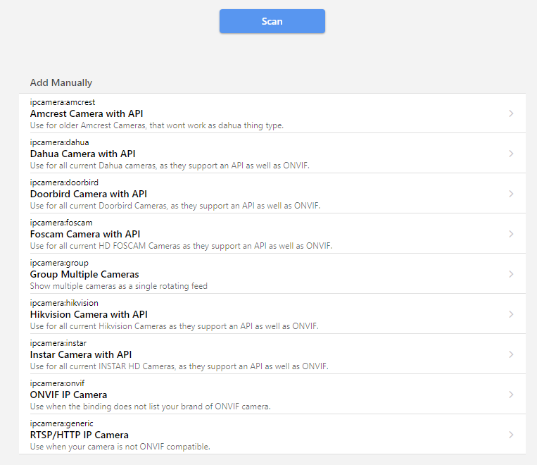

What IP Camera Binding Thing should I be using?
I have been experimenting with RTSP/HTTP IP Camera and seem to have the camera online, but none of the links that are generated work and there is no image in the Image item.
I think the camera may support ONVIF? But I didn’t have much luck experimenting with the ONVIF Camera Thing.

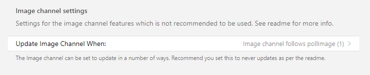

I can’t help with this specific device, but I do know that the Image Item will only be populated when the Switch Item linked to the Poll Image Channel is ON.
I had tried that.

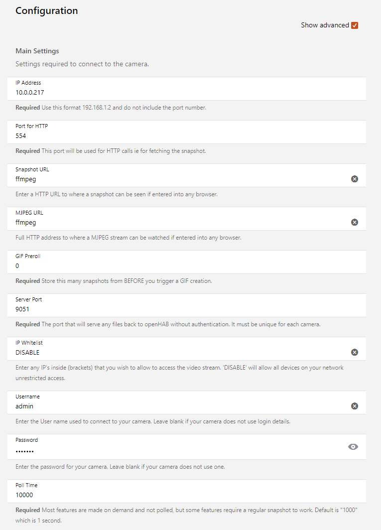

I am guessing to use port 554 for Port for HTTP, inferred from the working RTSP link.
I am using a random port number for Server Port. Is this right?
I am using the link that works in VLC for FFmpeg Input.
Everything else is default.

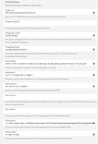

What happens if you enter this
-rtsp_transport udp
into the FFmpeg Input Options config?
If your camera does not have a snapshot URL then it does not matter what you set it to if the cameras stays ONLINE.
correct. Looking at your logs I can see something interesting which may be a bug. It says the port is serving on 45230 and then in the ffmpeg output it shows it will be using 2100 when these two numbers should match. Any ideas why they don’t match, steps to reproduce that?

Your camera did not support TCP, so if you see patchy video maybe partly missing picture or the odd green square show up, that will be normal for UDP.
Yes the binding disables that by default as it is not a good idea to do that unless you need a picture that stays on the last motion seen. Use the widgets and the snapshot or mjpeg streams to show a picture. If your only doing a single camera it is not too much of an issue.
