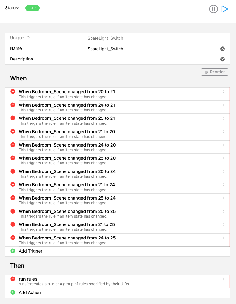

A toggle switch is turning two lights on / off. All is configured within the OH3-UI. It works stable. But the rule that triggers the script looks “awful”. Do you have a more elegant solution?
Thanks for any hints.

The rule needs to track when the Scene Number changes from one number to another.
All simpler approaches lead into uncontrolled switching of the light (e.g. switching the light whenever openhab restarts.):
  • A simple “update” of the state of the Scene Number, or
  • A trigger like “null” to 21
configuration: {}
triggers:

The “from state” and “to state” sections of the trigger dialog are optional. You just want just one “changed” without any specifier. Then your rule will trigger not on every update from the device (that’s “item updated”) but only when an update from the device causes the item state to change. Since you explicitly test for the all specific states in the rule script that you care about, it shouldn’t really matter what the state changes to or changes from.
Hi Justin
Thanks for your reply.
It seems not to work without the “from state” and “to state” sections as shown bellow.

Your recommended trigger works in principle (I don’t know what I messed up in the first attempt). Unfortunately the initial problem persists, which triggers this rule whenever openhab restarts. This is because this scene changes from “NULL” to whichever state the item has. You find this also in the “event.logs”:
2022-04-27 13:34:03.375 [INFO ] [openhab.event.ItemStateChangedEvent ] - Item 'Bedroom_Scene' changed from NULL to 20
What might work is a trigger that excludes an item change “from state” NULL.
Do you know how I had to write this?
I found a simpler way to build the trigger, since I’m aware that the “state” and “previousState” is optional. Even more elegant would be a solution that excludes / filters “previousState” that are NULL. Is this possible after all? Could you help me with the syntax?
Thanks in advance.
Simon

This problem can be dealt with independent of the rule if you want. This is exactly what the the persistence feature of Restore On Startup is for. You can check out persistence setup and restoreOnStartup in the persistence docs (I personally use mapDB for this sort of thing).
Yes, handling the NULL state within the rule is the other perfectly viable option and there are two easy ways to do this.
Option 1: This is exactly what the rule conditions are for in the UI rules (the But only if section). There you can add a simple script. The last line of the script must evaluate to true or false and if true the rule will run and if false the will will not run. So here you could a script (assuming the built-in javascript option) that says:
(event.oldItemState != 'NULL')
The entire condition would look like this:
conditions:
  - inputs: {}
    configuration:
      type: application/javascript
      script: (event.oldItemState != 'NULL')
    type: script.ScriptCondition
Option 2: Just add a similar check to the top of your rule already existing rule script.
Works like a charm. Thanks a lot.
