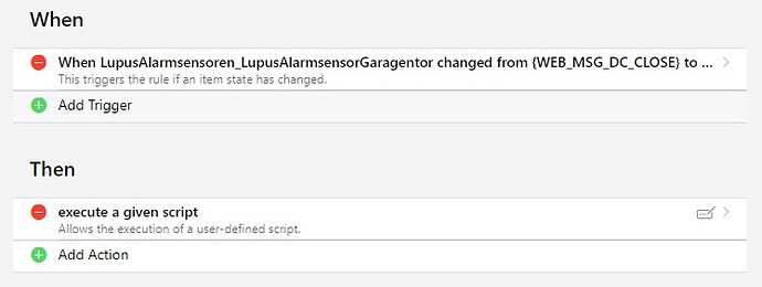

I am not sure what you meant with “before” … please see attached screenshot on how i jump into that rule.
