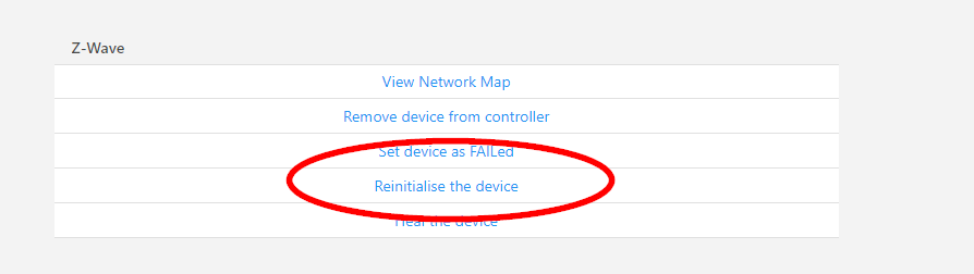

I’m trying to remember what I had to do when I made this same mistake upon upgrading to OH3. I think I just had to wake up the lock multiple times before the secure inclusion succeeded, but I may also have deleted the XML file for that node from the ZWave folder to give it a clean slate.
Good input - I started a re-initilize on the device and let it sit for a while. Didn’t seem to make a difference, so decided to remove and re-add one more time. This time, it only shows as a generic zwave device (not detecting the specific device type/model), BUT, it did add as secure, and even now allows me to set user codes.
Okay, hopefully waking it a few more times will get it to complete the process.
Anything special you did for your wake up process? I’ve temporarily decreased the polling interval and also done both Heal and re-initialize, but it’s still showing as generic device. I know the notes in the OH screen for the thing mention to check for device-specific wake up process, but I pulled out the user guide on the lock and didn’t see anything listed (just inclusion and exclusion).
I think I just disconnected and reconnected the battery holder.
Makes sense - thanks. I’ve done that, but will give it a few more tries over the rest of the day as well.

I have two Locks. Same issue, both were included without “secure”. The trick for me was first to change the security key for the one running on OH2, as @rpwong said. After that I had to Reinitialise the device by the way of the UI and finally remove the Thing and include it again. Work for both lock at first attemp.
