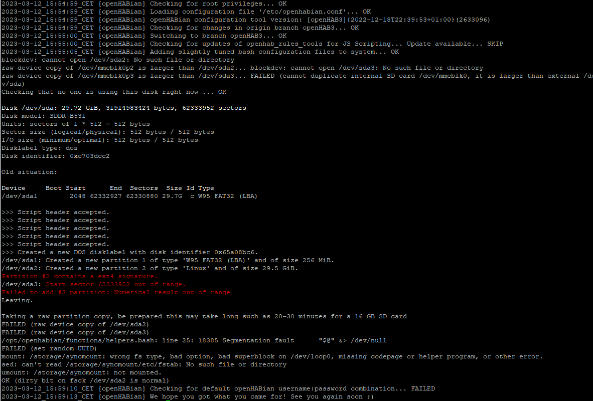

BUT: Now my 64G backup card is inserted. And i want to use my 32G normal card again, to have my 64G card again as a backup. But i am unable to copy the backup card to the normal card with menu option 54. How to solve this issue?

I’d think it would have worked if you had had the most recent openHABian version when you’ve setup mirroring, but that’s speculation. Now you would need to reinstall or get a bigger card.

No, you can use a backup card as big as the orig one. Just the first two partitions should take part in mirroring.
And as I said you can reinstall (on a small SD, of course) and import your old config to “set back” size.

You have a couple of options however I recommend using AMANDA as well as Mirroring.
Setup AMANDA on you current system then restore the backup on your smaller card.
You could also mount your SD on a Linux system and shrink the partitions.

Am i able to auto backup to an SD card the same size the original card has? Or am i only able to raw copy manually to an SD card the same size?
There’s no difference.
