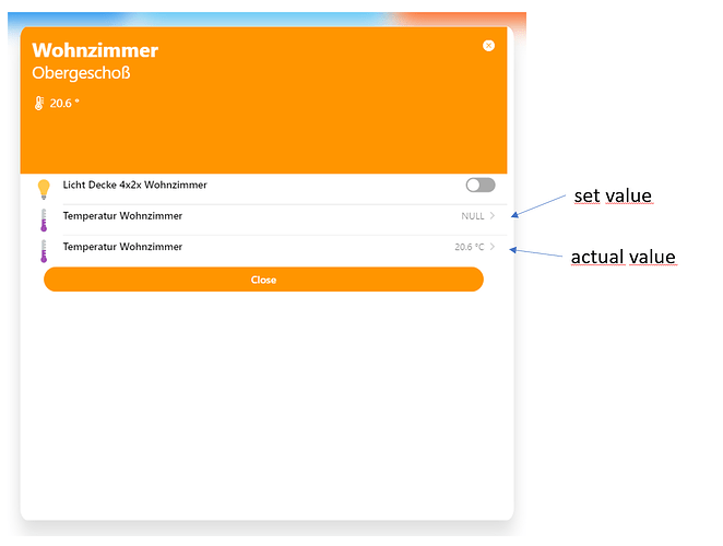

I would like to set the temperature of a thermostat. What do I have to do, that automatically in the location overview an input option is displayed? I have already declared the item for temperature setpoint as “Mearusement” “SetPoint”. When I click on the setpoint, I do not expect a diagram, but an input option. Where the NULL is in the screenshot, I would like to see some kind of slider or something similar.

Yes,
Go to the Model, find your setpoint item, then click “Add metadata” > “Default List Item Widget” and then change the widget type from “Default” to “Stepper List Item” or “Slider List Item”, whichever you prefer.
Complete the details and save.
