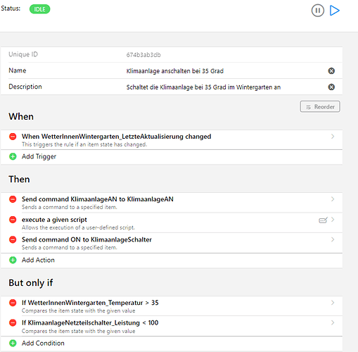

meanwhile I have two rule which fully automaticly switch my clima-unit in my wintergarden on and off, depending on the temperature reported by my shelly H&T. On with 35 degrees, off by 33 degrees.
Look here:
What is the special here? Only two rules, in combination, then I also can use a shelly Button1 to switch it on and off, when ever someone wants, but also it goes automaticly on, or off.
