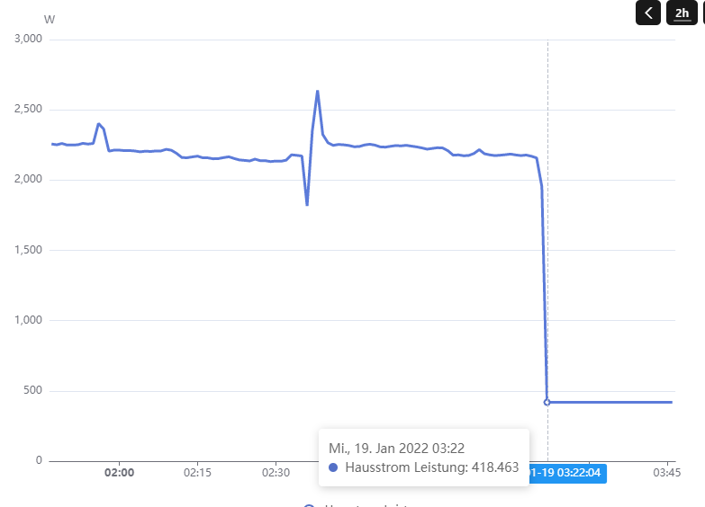

- Issue of the topic: Every now and then I observe, that OpenHAB stops executing certain rules and stops polling some devices (especially my SenecHome inverter). I now realized, that this coincides with a log entry, saying that the connection to openhab cloud service has been lost:
2022-01-19 03:22:31.422 [ERROR] [io.openhabcloud.internal.CloudClient] - Error connecting to the openHAB Cloud instance
2022-01-19 03:22:31.427 [INFO ] [io.openhabcloud.internal.CloudClient] - Disconnected from the openHAB Cloud service (UUID = 9e6a409b-1ad7-4c59-9c12-4c8612f7659a, base URL = http://localhost:8086)
2022-01-19 03:22:32.931 [INFO ] [io.openhabcloud.internal.CloudClient] - Connected to the openHAB Cloud service (UUID = 9e6a409b-1ad7-4c59-9c12-4c8612f7659a, base URL = http://localhost:8086)
You can see that polling of SenecHome stopped at exactly this time:
Can anyone give me some hint, what could be going wrong there?
