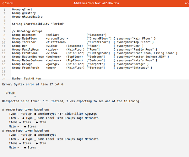

So, for Items you can import them using .items file syntax.
Choose “Add Items from Textual Definition” and write or paste in your Items definitions.
Notice the built in syntax checking.
I imported about a hundred Items in one go that way (I’ve since started just creating the Items anew through the UI because it’s so darned easy to do so through the Model). Yannick has mentioned he might look into doing the same for Things at some point. If that happens, you could write a .things file type syntax for a bunch of things and import them all in one go. Editing already imported Things and Items is where the trouble will be.
