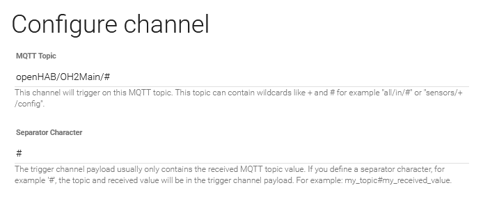

a short q.e.d. just now:
just a misspelled seperator instead of separator and boom: ~2+ hours from my side and I guess a few from others in a stupid thing configuration! :wink:
