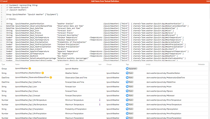

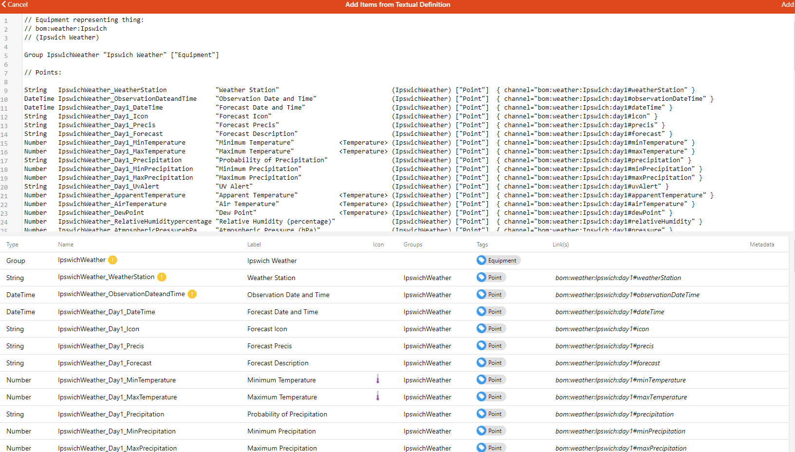

Absolutely not my prerogative to unilaterally decide which way to go - I only made the UI and tried to make it a viable (and hopefully for many, even appealing) option to configure your system. That somehow became presented as the “recommended” way to go in the docs, but I don’t think it was me who worded it that way when I wrote the pros & cons.
Whether the text based configuration will be deprecated because there’s a more capable UI now is a decision to be taken by the core runtime maintainers, and rest assured it’s clearly not on the roadmap, probably never will.
On the UI writing back to your text files, what is also something that probably won’t be supported ever because it simply wouldn’t work. My stance on this and on whether you should prefer the UI-based configuration or not: Getting Started with OH3: rewriting the tutorial - 1. Introduction - #111 by ysc

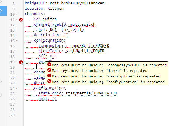

Don’t edit the json db while openHAB is running so for me I never will do it this way.
Main UI highlights errors before you try and load them into database.
Honestly I felt the exact same way it is hard to learn new things. Once you get the hang of things it hard to go back to not know how to do it and update the docks.
As there is more than one way of doing thing you have only 2 types of code. One that is not yet working and one that works.
Most of my help on here is looking at the question reading the docs and answering in a more detailed post. Some people are just not knowledgeable enough to read a doc and get it. Especially if the doc is written by someone who’s first language is different to English.
Yep more examples will make it easier for new users. Stick some in the doc’s
Pros
They can be edited with any text editor,
Cons
Syntax errors will make you loose hair.
It is and you have done excellent. It is better than some professional tools I have used. You are just 1 man changing the world one line a time and I am so thankful for all the effort you put in. I could write a whole list of things I want in the UI however I assume you they are already on your list.
One way would be to display them on the screen like in Expert mode in screenshot above to be copied. To me this would be a waste of time as we go forward and the norm becomes using the UI these features wont be needed.

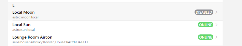

You only get one jsondb and you can disable things for example I will disable the moon
Problem is when I look outside I can see the moon.
You can disable Rules too
