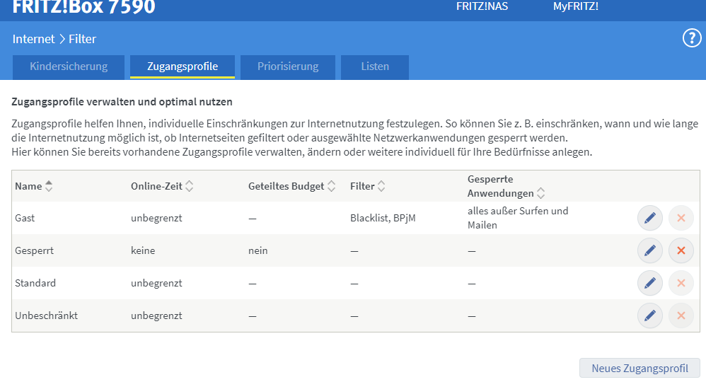

There are 2 parameters now on the Box UI:
  1. Internet Access: Blocked / Unblocked
  2. Internet Usage: You can select Pofiles there. Standard / Blocked / Unblocked (Default but can be extented / edited: see below)

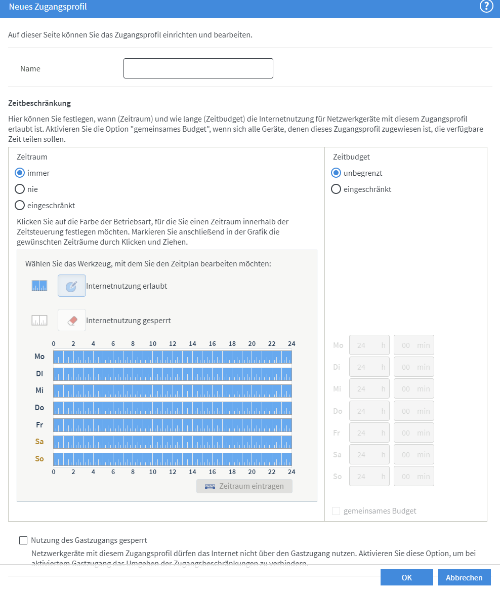

For 2. the Profiles are done in another section and allows you to create multiple new profiles like time budgets for access or based on time of day.

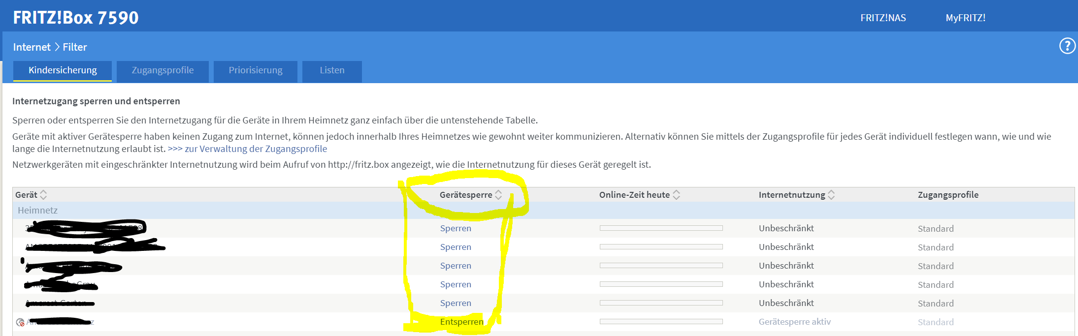

I think after looking at it again that only 1. is affected by the new WAN Block feature and has is only boolean.
If a Trace helps you nevertheless I will do that for you of course.
I think we control „Internet Access blocked/unblocked“. So a Switch is Fine. Thanks.
yes correct
I gets more clear on that UI:
The WAN Block feature over TR64 only controls the “Gerätesperre”.
So a switch is perfect :slight_smile: Thanks again! :slight_smile:
