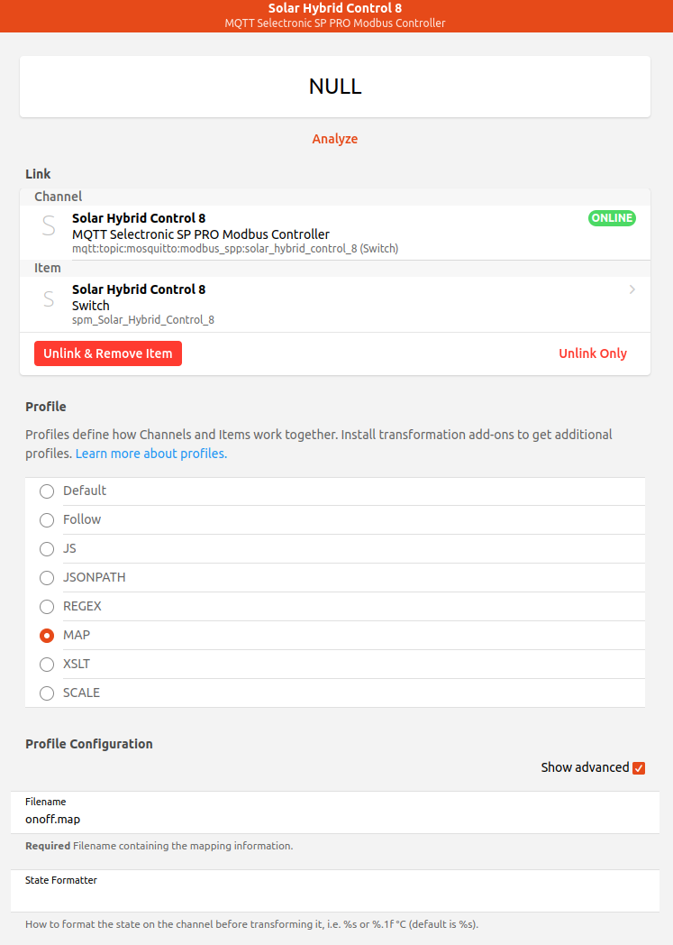

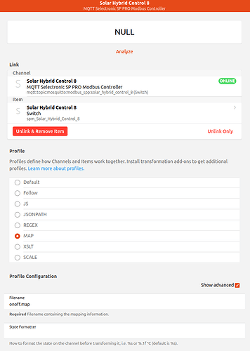

I have a MQTT thing with a channel (switch) linked to an item (switch) and use a map to transform 0|1 to ON|OFF
However, I get a warning, and the switch does not work.

profiles operate on links. That’s to say, on the link between channel and Item.
Your error message comes from the channel, which being a switch type channel, is trying to convert the MQTT payload into standard ON/OFF long before the update gets to the profile,
If you wanted to do it this for an experiment or something, use a string type MQTT channel so that it doesn’t care what the payload is.
The more conventional approach is to use the “mini-mapping” built in the MQTT channel for on= and off= arguments, and not use a profile at all.
Or failing that use the transformation feature built into the MQTT channel to use your MAP, again not using a profile at all.

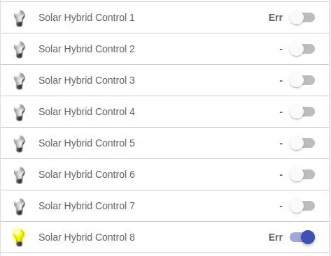

Thanks… since I posted this I changed the channel to a number type.
This at least ‘flicked’ the switch… but produces and Err in the sitemap.
Switch 1 and 8 have been changed to number, the others are still switch.

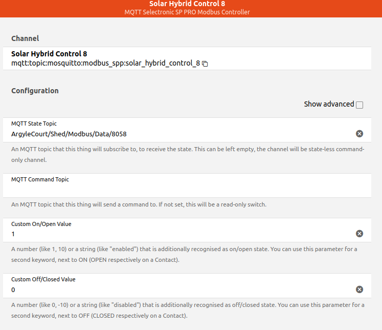

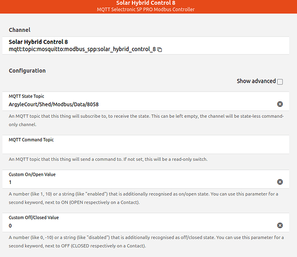

@rossko57 is saying to do this:
Get rid of the MAP transformation pattern. Get rid of the profile on the link.
Just make it a Switch Channel and fill in the Custom On/Open Value and the Custom Off/Closed Value parameters.
It’ll look like this in the code tab.
  - id: garagedoor1_opener
    channelTypeUID: mqtt:switch
    label: Large garage door opener
    description: ""
    configuration:
      commandTopic: sensor_reporter/cerberos/garagedoor1/cmd
      off: OFF
      on: ON
In Max’s case, he wants off=0 on=1 I think.

The below works.
