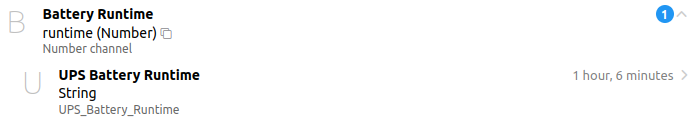

I installed the NetWorkTools binding for the UPS connected to the openHABian Pi.
The binding has built-in channels; one of which is ‘Battery Runtime’. It comes across as Number:Time: 4000 s.
I have unit-less JS transfomrations that don’t seem to work on numbers with units.
So I created a new channel, as number… applied the transformation and show it in a string item.
This doesn’t seem right to me; or units make life more difficult to work with.
Is there a better way?

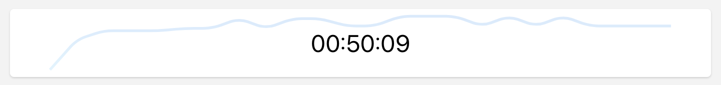

The way I set up the UPS runtime Item in my setup is as follows:
  1. Number:Time
  2. State Description Pattern: %1$tH:%1$tM:%1$tS
That keeps the value as a number so it can be charted or do math with it in rules. Number:Time Items support DateTime formatting up to 30 days. To get the output you are showing use pattern %1$tH hour, %1$tM minutes.
If you want the transform to be smarter and use hours when there is more than one (for example) use. a JS transform on the State Description Pattern. Keep the Item a Number:Time Item so you can do math and chart and such and just change how it’s displayed.

All that was required, is what you suggested…
I deleted the extra channel; changed the string time to a Number:Time item and selected the output format. Done, works.
