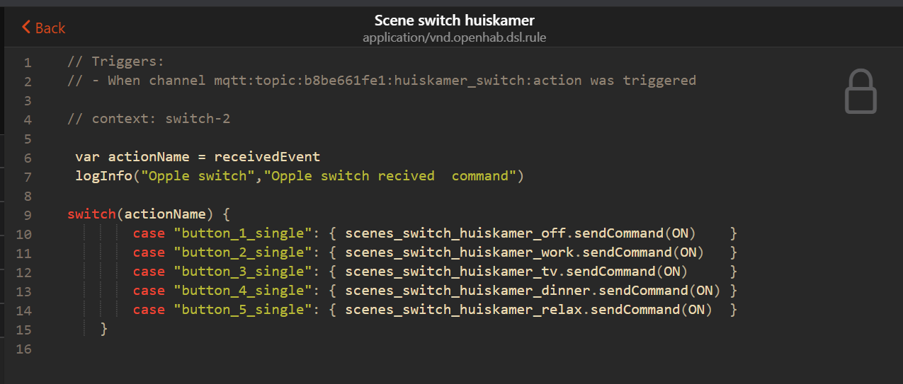

I am trying to create a rule / script that responds to my 6 button switch
I tried with a trigger rule that then starts a script but it didn’t work.

Then I thought! what if I use a .rules file, like I would in openHAB 2.X.
rule "Scene switch huiskamer"
Channel "mqtt:topic:b8be661fe1:huiskamer_switch:action" triggered
var actionName = receivedEvent
logInfo("Opple switch","Opple switch recived command")
switch(actionName) {
case "button_1_single": { scenes_switch_huiskamer_off.sendCommand(ON) }
case "button_2_single": { scenes_switch_huiskamer_work.sendCommand(ON) }
case "button_3_single": { scenes_switch_huiskamer_tv.sendCommand(ON) }
case "button_4_single": { scenes_switch_huiskamer_dinner.sendCommand(ON) }
case "button_5_single": { scenes_switch_huiskamer_relax.sendCommand(ON) }
When I do that, the file is read by OH3 without errors. But the first lines are ignored (comment out)
anyone any idea what i am doing wrong?

I have an Aqara Opple 6 way switch.
if I press button 1 the action channel changed to “button_1_single” and for button 2 “button_2_single” etc.
I can make a rule (main UI) for every singel button (6X), but “switch case rule/script in DSL” look like a beter solution!?
I made a DSL rule in a file named xxx.rules in the /rules folder
So I don’t know what you mean by “have to hand-edit it”
I have turned off the rules that I made via the UI
So that only the rule in the xxxx.rules file does its job.
When I look from the UI at the rule I created in the xxx.rules file the first 3 lines are ignored.
