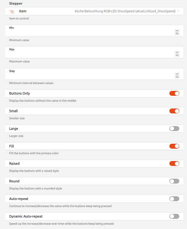

Unfortunately not. This is what I was looking for, but for the stepper widget there seems to be no option to change the action behavior… See screenshot (Advanced box is checked)
