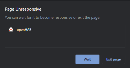

I’ve noticed that navigation within the OH 3 UI is very slow and sometimes unresponsive. I frequently get the below warning from Chrome stating that the page is unresponsive when trying to navigate to Settings or Developer Tools requiring me to frequently refresh the page. Is this a known issue or do I perhaps have a localized problem causing the UI to run extremely slow? I know there’s not a lot of info here, but if others are running a similar hardware setup with no issues navigating the UI, that answers my question. Thanks in advance.
4GB rpi4, openHABian 3.1.0.M2
