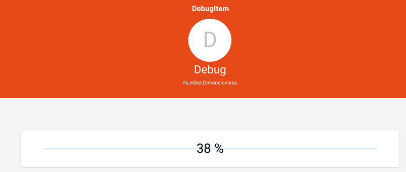

And with the following pattern:
this results in:
But i tested this in a debugItem which changed its type some times, so maybe there is only a chart issue left? Now i’m back at home and can do some more testing to it.
i created a new item, wrote to it like the debugItem in my post before but sadly everything looks the same… in a chart it shows 0.38% instead of 38%.
I think the item is good so far as i can see in the events.log but the graph isn’t. Any further idea?
